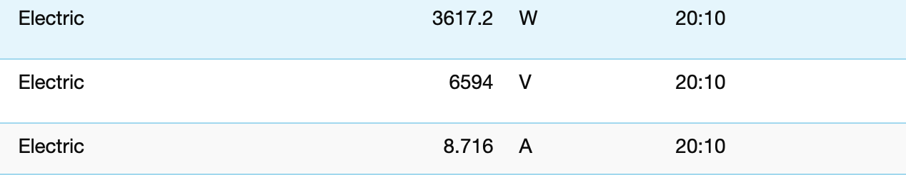

I've two Qubino Smart Plug's, which have been working fine for several weeks, until a week ago one of the devices suddenly failed.
I've re-included the failed device, and it has been working fine, except for some of the sensor values, it reports very weird values.
I've performed a factory reset of the device, and re-included it again, however it keeps reporting weird values on the voltage/amperage/watt sensors, the meter (kWH) report seems accurate though.
Could this have something to do with the z-way software, is there anything I can do to debug / make sure it's a hardware problem before returning it to the supplier?

Hi, had something similiar with devices that I bought 2nd hand. I had to Reset them in the
Expert - Control - Meters section. (I assume that your screenshot is from this page also)
Seems that these devices hold the values, which i didn´t expect, or there is some wrong
interpretation in z-way.

Worth to check the log, but I would opt for device issue.

I've reset the meter, somehow that only resets the actual meter, not the sensor values, it's the sensor that's being problematic, and I can't find a reset option software wise for the sensors. Thats why I did a factory reset on the device itself, didn't help either.
Hereby the logs, from what I make up here, the device actually reports these "weird" values itself ?

[2020-10-16 13:49:56.069] [D] [zway] SETDATA devices.50.instances.0.commandClasses.50.data.5.ratetype = 1 (0x00000001)
[2020-10-16 13:49:56.071] [D] [zway] SETDATA devices.50.instances.0.commandClasses.50.data.5 = Empty
[2020-10-16 13:49:56.122] [I] [core] HK: updated ZWayVDev_zway_50-0-50-5
Posts: 7650
Re: Qubino Smart Plug - weird voltage/amperage readings
Looks like. You can send it to Goap for investigation.
