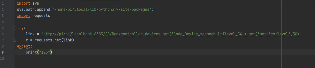

I want to use a virtual device to execute a python code, but when the python code includes the request.get() function running in the virtual device, it will break down the website system port(8083). The z-way-server got 100% loading and the web system will keep loading and cannot to use. However, I run it(python code) in the putty and it works well. How could I run it on a virtual device?

Am I right that on CodeDevice click you are running a Python script that is making a request to the Z-Way server again?
The server web handling is synchronous. You press a button, webserver handles it and execute CodeDevice that does a shell execution of python that tries a sync http request to the same server and will wait until the command is executed, but it can't since the previous is still in execution until your Python ends, which is waiting for the http to finalize. So, you are in a dead loop.
But why not to execute everything inside the Z-Way JavaScript engine without python?

@PoltoS , I have another task in python so I cannot do it in the js engine. Can we change from python to shell script and shell script to call python? Can it avoid the deadloop problem?
Re: about virtual device problem
The dead loop happens when you call synchronouslynsomehing that is calling Z-Way HTTP API and eaits for it.
So either do a sync execution (with &), so that Z-Way can end the system call and proceed with the new HTTP API request from tour script.
Does not matter python or ahell

Thanks, it works well.
