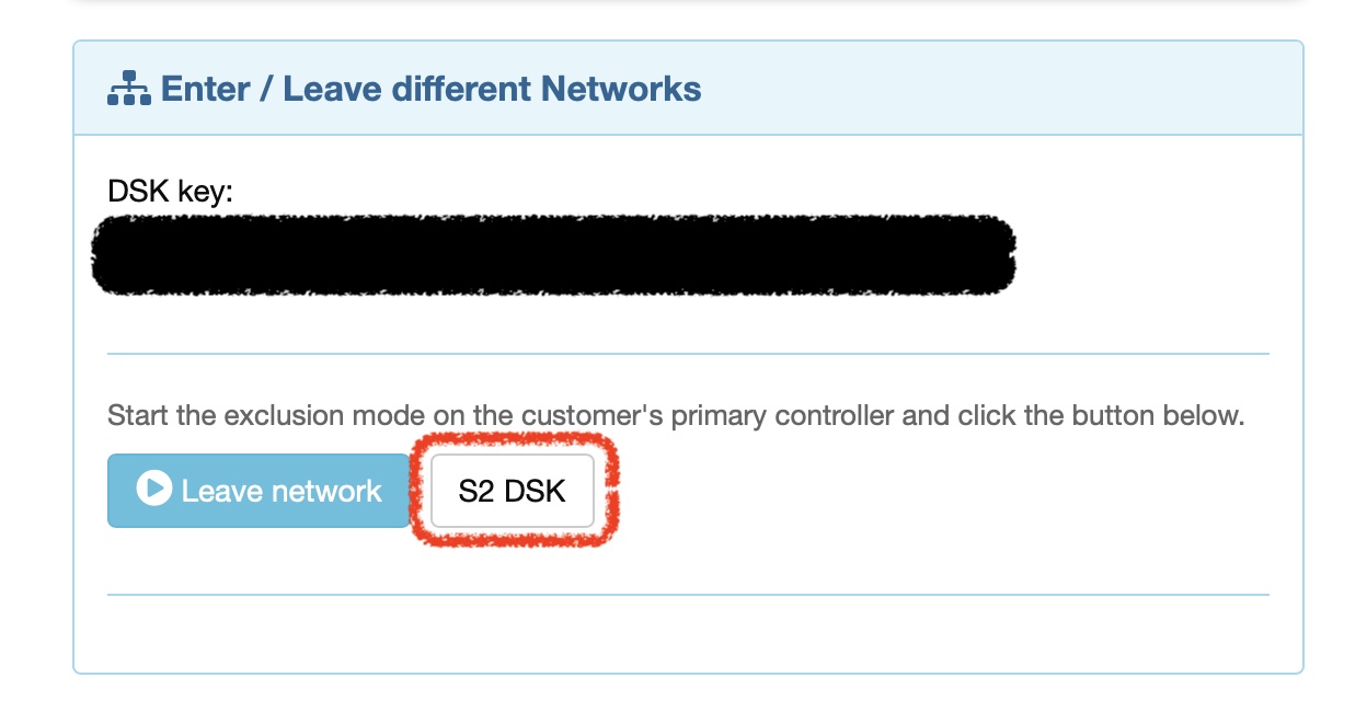

The problem is that the QR code that is generated in the Advanced interface is not valid. A valid QR code for a S2 DSK begins with a 9 and is longer. According to my notes, the DSK begins 13 characters in on the QR code.
I have circled in red the link to the QR code link.

Re: Adding a RaZberry to another network, DSK
that might be true. will check it
Indeed, this is a bug, it will be fixed in the next version
