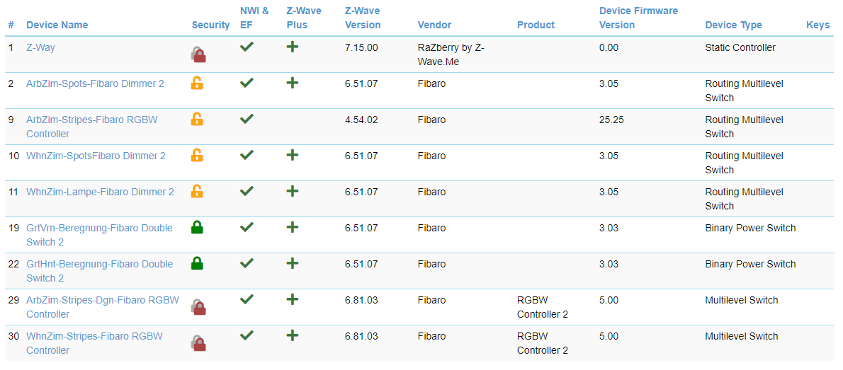

@IanBrown: yes, but what about the RGBW controllers. As you can see in the Attachment, the controllers have different Z-Wave-Versions and different Device Firmware Version. The RGBW Controller with number 9 is the working one. It has an older Z-Wave Version 4.54.02 and the Firmware Version is much older two. Numbers 29 and 30 are the newer controllers where Z-Wave Version and Firmware are much higher.
