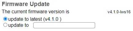

But I do not have time waiting for your solution. PLEASE confirm method @seattleneil proposed for getting back to v4.0.3
'export BUILD=4.0.3-lws16; cd /tmp/ && wget https://storage.z-wave.me/z-way-server/ ... _armhf.deb && sudo dpkg -i z-way-${BUILD}_armhf.deb'
I am no sure if I can even retype it correctly :-(
or explain if/how web 'downgrade' works:
2023-06-17 071536.jpg (12.87 KiB) Viewed 25875 times

I have downgraded a few times.
Use the 'update to' option as you have just posted. I assume that's your preferred method.
put v4.0.3 in the box
That will Downgrade your system to 4.0.3
Take both backups. .zbk and .zbw before you start.
You cant go wrong.

This method DOES NOT work.
Oh that's not the reply I expected.
What error do you get ?

The upgrade/downgrade process starts. When finished version is still v4.1.0. No messages, no report, no errors, no nothing.
