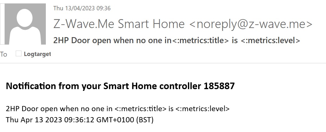

hmm not quite sure that works ...
email response
email response

Re: NotificationChannelEmail Trigger Details
Sure you have Z-Way version 4.0.2 or upper?

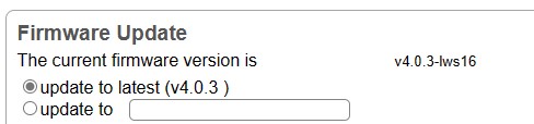

Post by topcatsss »
yup
4.0.3
Screenshot 2023-04-19 094202.jpg (14.34 KiB) Viewed 31560 times
This works only in device's notifications (go in device settings and set them there), but not in the Automation section and other modules like NotificationChannelEmail.
https://github.com/Z-Wave-Me/home-autom ... d92daff86e
But you can copy&paste the code to other modules (prepareMessage function). If you decide to do it, you can then contribute and make a pull request.
