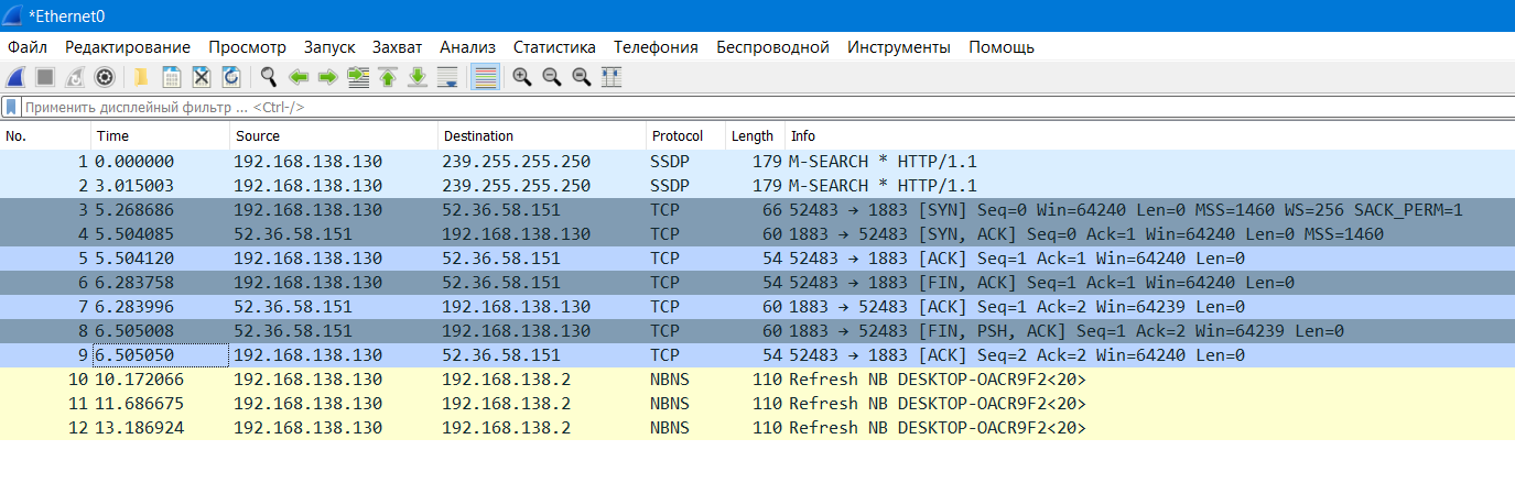

When using 3rd party app for publishing something on external MQTT broker (i'm using Broker.Emqx.Io) the traffic looks like this;
lens mqtt traffic.png (32.65 KiB) Viewed 12937 times
When using Zway it looks a bit different:
zway mqtt traffic.png (54.18 KiB) Viewed 12937 times
Here is a link to the captured traffic
https://drive.google.com/file/d/1tG4bzG ... sp=sharing
