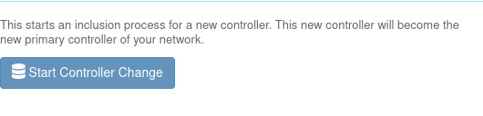

I have bought a razberry 7 pro to replace my razberry 2.
I have a completely new raspberry pi so my question is what will happen if I select this option from my screenshot?

Re: How to migrate to Razberry 7
@harre:
https://storage.z-wave.me/docs/zwayDev.pdf
The controller change function allows to handover the primary function to a different controller in
the network. The function works like a normal inclusion function but will hand over the primary
privilege to the new controller after inclusion. Z-Way will become a secondary controller of the
network. This function may be needed during installation of larger networks based on remote
controls only where Z-Way is solely used to do a convenient network setup and the primary
function is finally handed over to one of the remote controls.
to replace your razberry2 do what PoltoS described:
