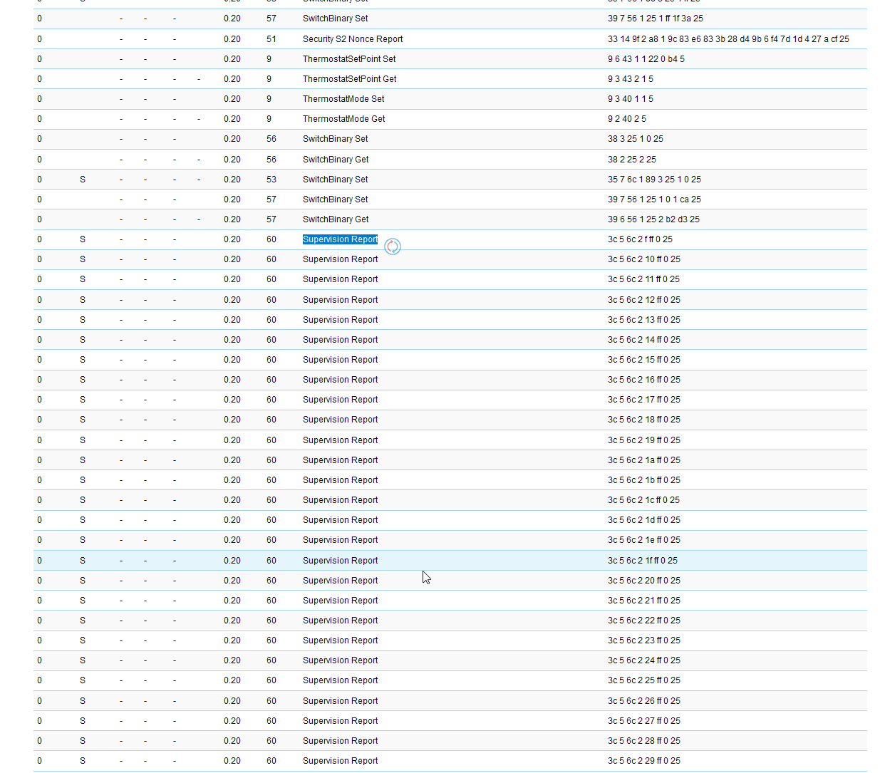

Happened again today - Screenshot of my expert GUI showing 110 jobs in queue and my z-way-server.log sent in PM to PoltoS
This seems like a software regression as it never happened before in years of running Z-Way, and I haven't added any new Z-Wave devices

so looks my Job Queue on this Failure....
What are an SuperVision Report ?
Greetings from germany
Jörg

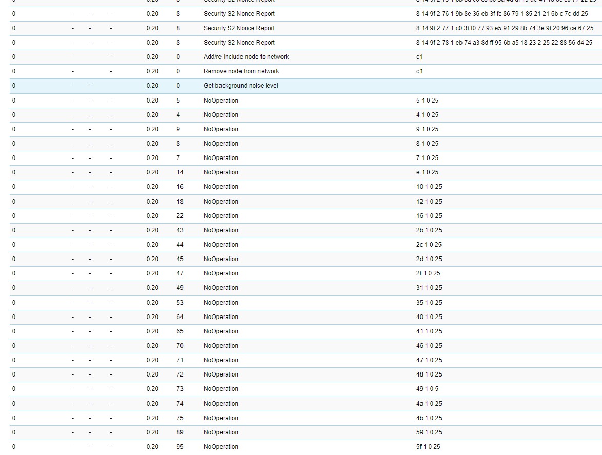

This status is after 3 days of not beeing home:
How do I send log file @PoltoS ? On PM there is no 'attach file' option.

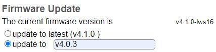

Would someone be so kind and instruct me how to revert back to v4.0.3.
Tryed:
...but still v4.1.0

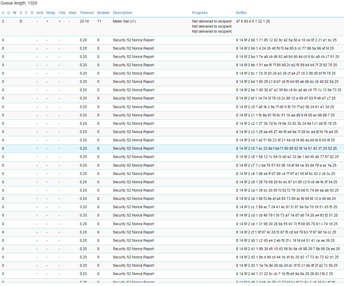

My Qubino 3 Phase smart meter:
2023-06-16 172811.jpg (324.88 KiB) Viewed 21927 times
Will exclude 3 Phase smart meter.

And end of Jobs queue. All my devices are unaccessible:
2023-06-16 173340.jpg (195.97 KiB) Viewed 21930 times

For users who are experiencing the problem, perhaps the best course of action is to roll back to version 4.0.3 until a bug fix is provided. I haven't tested the roll back command, but the following command should work in theory:
export BUILD=4.0.3-lws16; cd /tmp/ && wget https://storage.z-wave.me/z-way-server/z-way-4.0.3-lws16_armhf.deb && sudo dpkg -i z-way-${BUILD}_armhf.deb
