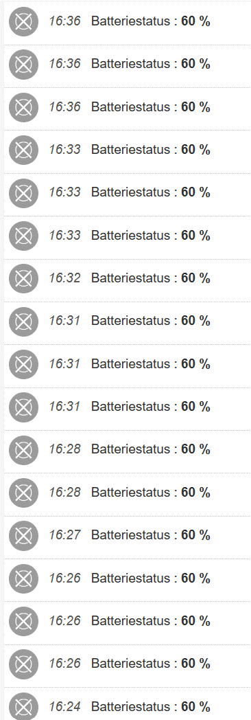

Hello again,
for me "Notifications by E-mail" caused high load (increasing over several days).
I'm still wondering about several not existing devices under expert view, analytics, signal strength. For example there are shown battery values of 60% every minute (see also case #806598).
Screenshot 2023-08-26 163745.gif (42.44 KiB) Viewed 118395 times
feuersee
Posts: 34
Joined: 07 Jan 2016 01:53
Post by feuersee »
60% events caused by battery polling app - removed app.
