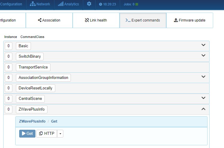

I don't think this is a problem. It simply means the controller and the node haven't had any 2-way communication. One way to create some communication is to use the expert UI and issue a command to the node. For example, go to Configuration->Expert Commands and issue a Get on the ZWave Plus command class as shown below.
expert command.jpg (59.03 KiB) Viewed 60722 times

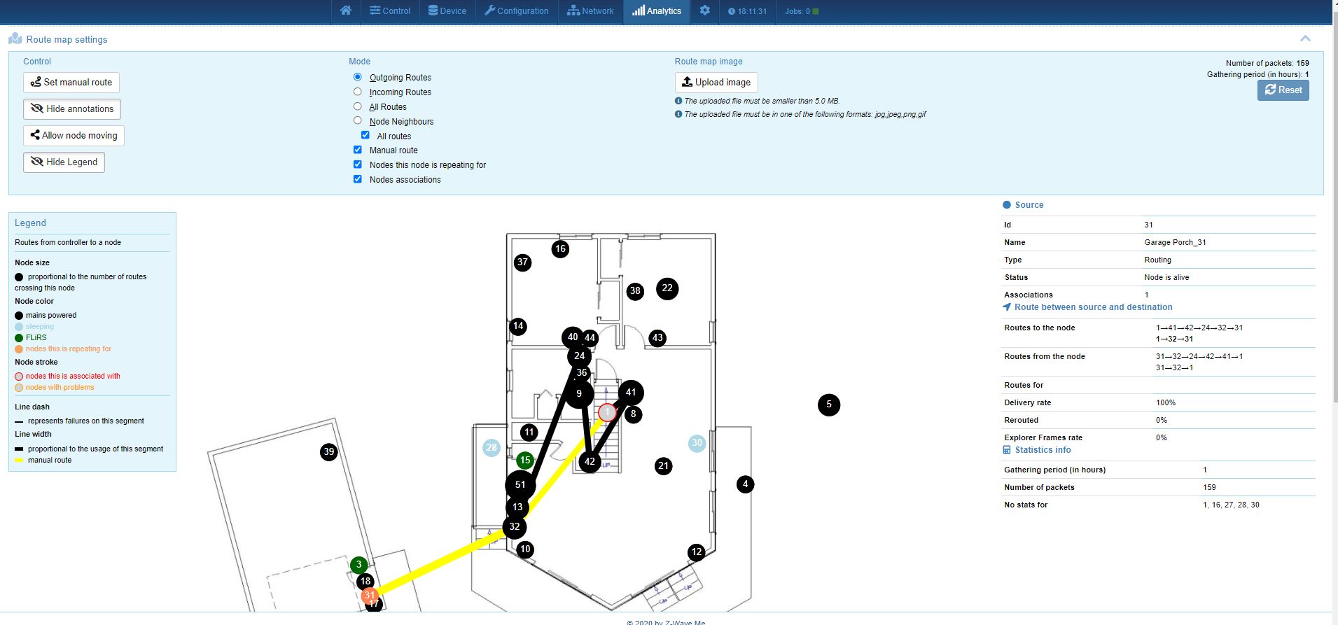

You can now go back to the Network Map where you should be able to see the to/from path for that node by hovering your mouse over the node. In my experience, it's very helpful to have a sketch of your floorplan and place your nodes at their location in your floorplan. Here's what my network map looks like:
route map.jpg (141.58 KiB) Viewed 60722 times
If you look carefully at the screenshot of my network map, you can see the route to/from my controller to node 31 based on a network reorganization is the crazy path of 1->41->42->24->32->31 (it appears as a black line). I added a manual route (it appears as a yellow line) of 1->32->31 which is much more direct. After adding the manual route, I tested the route by issuing another Get command. If you use this procedure for all of your nodes, you should be able to define a route map that works reliably. Deciding if/when to add a manual route involves some trial and error. Crazy multi-hop routes should get fixed. Also, if you have routes through nodes with poor signal strength, you'll be well-served to add a route using nodes that have good signal strength. You can see signal strength in installer/packets menu. You'll also need to use the network neighbors table to determine which nodes can see each other (you can't define a route using a node that does not have a green box to the next hop).
I suggest you tackle the route map 1 node at a time. For example, since you're having a problem with Nonce to a node, then check the to/from route for that node. As an aside, unless this node has a real need for security (e.g., it's a door lock), then I would exclude/re-include the node without security to reduce the number of packets.
