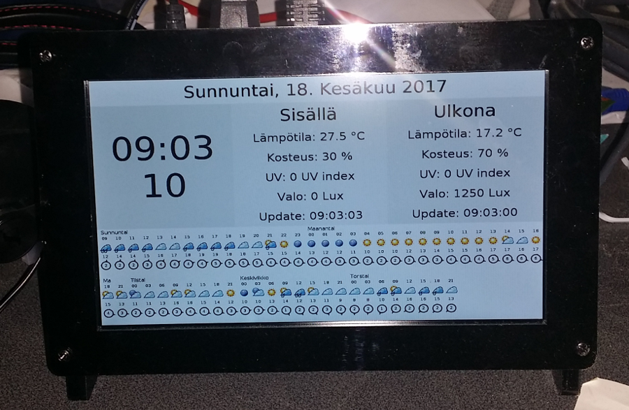

I have programmed own little wall clock around this system, it shows
* Current date
* Current time
* Current temperature, humid, UV, Light from multisensors (indoor and outdoor)
* Weather forecast for next 5 days.
-> All on 7" display. that is on all a time. (Display have little slot for Raspberry Pi behind the display).
-> this is not correct thread but I upload the picture here anyways. It's all finnish, but you get the idea.
* Current date
* Current time
