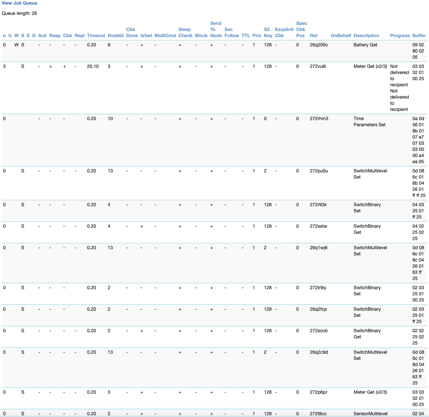

queue screenshot
queue screenshot
Screenshot 2023-07-03 at 09.09.17.png (224.78 KiB) Viewed 16787 times
johanneslarsson
Posts: 18
Joined: 29 Jun 2023 21:18
Post by johanneslarsson »
The full queue as json
[[0.20000000298023224, [0, 1, 1, 0, 0, 1, 0, 1, 0, 1, 0, 0, 1, 0, 0, 1, 0, 1, 0, 1, 0, 0, 1, 128, 0, 0], 9, "Battery Get", null, [9, 2, 128, 2, 5], 4030764512, []], [20.100000381469727, [3, 0, 1, 0, 0, 1, 0, 1, 1, 1, 1, 0, 1, 0, 0, 1, 0, 1, 0, 1, 0, 0, 1, 128, 0, 0], 3, "Meter Get (v2/3)", "Not delivered to recipient\nNot delivered to recipient", [3, 3, 50, 1, 0, 37], 4048551728, []], [0.20000000298023224, [0, 0, 0, 0, 0, 1, 0, 1, 0, 1, 0, 0, 0, 0, 0, 0, 0, 1, 0, 1, 0, 0, 1, 0, 0, 0], 10, "Time Parameters Set", null, [10, 13, 86, 1, 139, 1, 7, 231, 7, 3, 3, 0, 0, 164, 234, 5], 4048364848, []], [0.20000000298023224, [0, 0, 1, 0, 0, 1, 0, 1, 0, 1, 0, 0, 1, 0, 0, 0, 0, 1, 0, 1, 0, 0, 1, 2, 0, 0], 13, "SwitchMultilevel Set", null, [13, 8, 108, 1, 139, 4, 38, 1, 255, 255, 37], 4048294280, []], [0.20000000298023224, [0, 0, 1, 0, 0, 1, 0, 1, 0, 1, 0, 0, 0, 0, 0, 0, 0, 1, 0, 1, 0, 0, 1, 128, 0, 0], 4, "SwitchBinary Set", null, [4, 3, 37, 1, 255, 37], 4048354400, []], [0.20000000298023224, [0, 0, 1, 0, 0, 1, 0, 1, 0, 1, 0, 0, 1, 0, 0, 1, 0, 1, 0, 1, 0, 0, 1, 128, 0, 0], 4, "SwitchBinary Get", null, [4, 2, 37, 2, 37], 4048421472, []], [0.20000000298023224, [0, 0, 1, 0, 0, 1, 0, 1, 0, 1, 0, 0, 1, 0, 0, 0, 0, 1, 0, 1, 0, 0, 1, 2, 0, 0], 13, "SwitchMultilevel Set", null, [13, 8, 108, 1, 140, 4, 38, 1, 99, 255, 37], 4030761496, []], [0.20000000298023224, [0, 0, 1, 0, 0, 1, 0, 1, 0, 1, 0, 0, 0, 0, 0, 0, 0, 1, 0, 1, 0, 0, 1, 128, 0, 0], 2, "SwitchBinary Set", null, [2, 3, 37, 1, 0, 37], 4048462416, []], [0.20000000298023224, [0, 0, 1, 0, 0, 1, 0, 1, 0, 1, 0, 0, 0, 0, 0, 0, 0, 1, 0, 1, 0, 0, 1, 128, 0, 0], 2, "SwitchBinary Set", null, [2, 3, 37, 1, 255, 37], 4030783320, []], [0.20000000298023224, [0, 0, 1, 0, 0, 1, 0, 1, 0, 1, 0, 0, 1, 0, 0, 1, 0, 1, 0, 1, 0, 0, 1, 128, 0, 0], 2, "SwitchBinary Get", null, [2, 2, 37, 2, 37], 4048401256, []], [0.20000000298023224, [0, 0, 1, 0, 0, 1, 0, 1, 0, 1, 0, 0, 1, 0, 0, 0, 0, 1, 0, 1, 0, 0, 1, 2, 0, 0], 13, "SwitchMultilevel Set", null, [13, 8, 108, 1, 141, 4, 38, 1, 99, 255, 37], 4030779528, []], [0.20000000298023224, [0, 0, 0, 0, 0, 1, 0, 1, 0, 0, 0, 0, 0, 0, 0, 0, 0, 0, 0, 0, 0, 0, 1, 0, 0, 0], 0, "Get statistics gathered by the Z-Wave protocol", null, [], 4030842608, []], [0.20000000298023224, [0, 0, 1, 0, 0, 1, 0, 1, 0, 1, 0, 0, 1, 0, 0, 1, 0, 1, 0, 1, 0, 0, 1, 128, 0, 0], 2, "SensorMultilevel V5 Get", null, [2, 4, 49, 4, 4, 0, 37], 4048439232, []], [0.20000000298023224, [0, 0, 1, 0, 0, 1, 0, 1, 0, 1, 0, 0, 1, 0, 0, 1, 0, 1, 0, 1, 0, 0, 1, 128, 0, 0], 2, "Meter Get (v2/3)", null, [2, 3, 50, 1, 0, 37], 4048456584, []], [0.20000000298023224, [0, 0, 1, 0, 0, 1, 0, 1, 0, 1, 0, 0, 1, 0, 0, 1, 0, 1, 0, 1, 0, 0, 1, 128, 0, 0], 2, "Meter Get (v2/3)", null, [2, 3, 50, 1, 16, 37], 4048261632, []], [0.20000000298023224, [0, 0, 1, 0, 0, 1, 0, 1, 0, 1, 0, 0, 1, 0, 0, 1, 0, 1, 0, 1, 0, 0, 1, 128, 0, 0], 2, "Alarm Get (v3)", null, [2, 5, 113, 4, 0, 8, 0, 37], 4048263672, []], [0.20000000298023224, [0, 0, 1, 0, 0, 1, 0, 1, 0, 1, 0, 0, 1, 0, 0, 1, 0, 1, 0, 1, 0, 0, 1, 128, 0, 0], 3, "Meter Get (v2/3)", null, [3, 3, 50, 1, 0, 37], 4048265752, []], [0.20000000298023224, [0, 0, 1, 0, 0, 1, 0, 1, 0, 1, 0, 0, 1, 0, 0, 1, 0, 1, 0, 1, 0, 0, 1, 128, 0, 0], 3, "Meter Get (v2/3)", null, [3, 3, 50, 1, 16, 37], 4048268168, []], [0.20000000298023224, [0, 0, 1, 0, 0, 1, 0, 1, 0, 1, 0, 0, 1, 0, 0, 1, 0, 1, 0, 1, 0, 0, 1, 128, 0, 0], 3, "Alarm Get (v3)", null, [3, 5, 113, 4, 0, 8, 0, 37], 4048301880, []], [0.20000000298023224, [0, 0, 1, 0, 0, 1, 0, 1, 0, 1, 0, 0, 1, 0, 0, 1, 0, 1, 0, 1, 0, 0, 1, 128, 0, 0], 4, "SensorMultilevel V5 Get", null, [4, 4, 49, 4, 4, 0, 37], 4048283208, []], [0.20000000298023224, [0, 0, 1, 0, 0, 1, 0, 1, 0, 1, 0, 0, 1, 0, 0, 1, 0, 1, 0, 1, 0, 0, 1, 128, 0, 0], 4, "Meter Get (v2/3)", null, [4, 3, 50, 1, 0, 37], 4030778984, []], [0.20000000298023224, [0, 0, 1, 0, 0, 1, 0, 1, 0, 1, 0, 0, 1, 0, 0, 1, 0, 1, 0, 1, 0, 0, 1, 128, 0, 0], 4, "Meter Get (v2/3)", null, [4, 3, 50, 1, 16, 37], 4048281056, []], [0.20000000298023224, [0, 0, 1, 0, 0, 1, 0, 1, 0, 1, 0, 0, 1, 0, 0, 1, 0, 1, 0, 1, 0, 0, 1, 128, 0, 0], 4, "Alarm Get (v3)", null, [4, 5, 113, 4, 0, 8, 0, 37], 4030814984, []], [0.20000000298023224, [0, 0, 1, 0, 0, 1, 0, 1, 0, 1, 0, 0, 1, 0, 0, 1, 0, 1, 0, 1, 0, 0, 1, 2, 0, 0], 13, "Meter Get (v2/3)", null, [13, 3, 50, 1, 0, 37], 4030842680, []], [0.20000000298023224, [0, 0, 1, 0, 0, 1, 0, 1, 0, 1, 0, 0, 1, 0, 0, 1, 0, 1, 0, 1, 0, 0, 1, 2, 0, 0], 13, "Meter Get (v2/3)", null, [13, 3, 50, 1, 16, 37], 4048255416, []], [0.20000000298023224, [0, 0, 0, 0, 0, 1, 0, 1, 0, 0, 0, 0, 0, 0, 0, 0, 0, 0, 0, 0, 0, 0, 1, 0, 0, 0], 0, "Get background noise level", null, [], 4048310600, []]]

Good news! The issue was reproduced and located.
Why was it so hard to find and reproduce in our lab? And how it passed our release tests.
The issue happened when a Security S0 encrypted packet was not delivered three times in a row right after receiving a Nonce Report (which is very rare). The clean-up of the undelivered Security S0 packet was incorrect, making the queue stuck. The node became undelivered due to routing failures that happen from time to time in real life.
We are preparing the fix. Thank you all for your support.

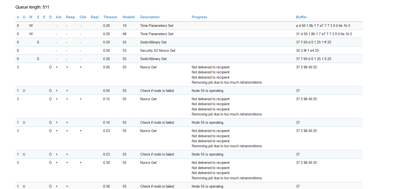

2023-07-07 07_59_41-Z-Wave Expert UI – Mozilla Firefox.png (50.51 KiB) Viewed 16615 times
[2023-07-07 00:00:00.020] [I] [zway] Job 0x13 (Nonce Get to node 55): Not delivered to recipient
[2023-07-07 00:00:00.021] [D] [zway] SENDING (cb 0xa4): ( 01 09 00 13 37 02 98 40 25 A4 89 )
[2023-07-07 00:00:00.025] [D] [zway] RECEIVED ACK
[2023-07-07 00:00:00.026] [D] [zway] RECEIVED: ( 01 04 01 13 01 E8 )
[2023-07-07 00:00:00.026] [D] [zway] SENT ACK
[2023-07-07 00:00:00.026] [D] [zway] Delivered to Z-Wave stack
[2023-07-07 00:00:00.031] [D] [zway] RECEIVED: ( 01 1D 00 13 A4 02 00 00 00 00 00 00 00 00 00 00 00 00 00 00 00 00 00 00 00 00 00 00 00 00 57 )
[2023-07-07 00:00:00.031] [D] [zway] SENT ACK
[2023-07-07 00:00:00.031] [I] [zway] Job 0x13 (Nonce Get to node 55): Not delivered to recipient
[2023-07-07 00:00:00.032] [D] [zway] SENDING (cb 0xa5): ( 01 09 00 13 37 02 98 40 25 A5 88 )
[2023-07-07 00:00:00.035] [D] [zway] RECEIVED ACK
[2023-07-07 00:00:00.036] [D] [zway] RECEIVED: ( 01 04 01 13 01 E8 )
[2023-07-07 00:00:00.036] [D] [zway] SENT ACK
[2023-07-07 00:00:00.036] [D] [zway] Delivered to Z-Wave stack
[2023-07-07 00:00:00.041] [D] [zway] RECEIVED: ( 01 1D 00 13 A5 02 00 00 00 00 00 00 00 00 00 00 00 00 00 00 00 00 00 00 00 00 00 00 00 00 56 )
[2023-07-07 00:00:00.041] [D] [zway] SENT ACK
[2023-07-07 00:00:00.041] [I] [zway] Job 0x13 (Nonce Get to node 55): Not delivered to recipient
[2023-07-07 00:00:00.042] [I] [zway] Job 0x13 (Nonce Get to node 55): Removing job due to too much retransmitions
[2023-07-07 00:00:00.042] [I] [zway] Adding job: Check if node is failed to node 55
[2023-07-07 00:00:00.042] [D] [zway] Job 0x13 (Nonce Get to node 55): fail
[2023-07-07 00:00:00.042] [I] [zway] Node 55:0 CC Security: sending Nonce Get
[2023-07-07 00:00:00.042] [D] [zway] SETDATA devices.55.instances.0.commandClasses.152.data.rNonceAckWait = **********
[2023-07-07 00:00:00.042] [I] [zway] Adding job: Nonce Get to node 55
[2023-07-07 00:00:00.042] [I] [zway] Removing job: Nonce Get to node 55
[2023-07-07 00:00:00.042] [D] [zway] SENDING: ( 01 04 00 62 37 AE )
[2023-07-07 00:00:00.045] [D] [zway] RECEIVED ACK
[2023-07-07 00:00:00.046] [D] [zway] RECEIVED: ( 01 04 01 62 00 98 )
[2023-07-07 00:00:00.046] [D] [zway] SENT ACK
[2023-07-07 00:00:00.046] [D] [zway] SETDATA devices.55.data.isFailed = False
[2023-07-07 00:00:00.046] [I] [zway] Job 0x62 (Check if node is failed to node 55): Node 55 is operating
[2023-07-07 00:00:00.046] [D] [zway] Job 0x62 (Check if node is failed to node 55): success
[2023-07-07 00:00:00.046] [D] [zway] SETDATA devices.55.data.failureCount = 0 (0x00000000)
[2023-07-07 00:00:00.046] [D] [zway] SETDATA devices.55.data.lastSendInternal = **********
[2023-07-07 00:00:00.046] [I] [zway] Removing job: Check if node is failed to node 55
[2023-07-07 00:00:00.088] [D] [zway] SENDING (cb 0xa6): ( 01 09 00 13 37 02 98 40 25 A6 8B )
[2023-07-07 00:00:00.091] [D] [zway] RECEIVED ACK
[2023-07-07 00:00:00.092] [D] [zway] RECEIVED: ( 01 04 01 13 01 E8 )
[2023-07-07 00:00:00.092] [D] [zway] SENT ACK
[2023-07-07 00:00:00.092] [D] [zway] Delivered to Z-Wave stack
[2023-07-07 00:00:00.097] [D] [zway] RECEIVED: ( 01 1D 00 13 A6 02 00 00 00 00 00 00 00 00 00 00 00 00 00 00 00 00 00 00 00 00 00 00 00 00 55 )
[2023-07-07 00:00:00.097] [D] [zway] SENT ACK
[2023-07-07 00:00:00.097] [I] [zway] Job 0x13 (Nonce Get to node 55): Not delivered to recipient
[2023-07-07 00:00:00.098] [D] [zway] SENDING (cb 0xa7): ( 01 09 00 13 37 02 98 40 25 A7 8A )
[2023-07-07 00:00:00.102] [D] [zway] RECEIVED ACK
[2023-07-07 00:00:00.103] [D] [zway] RECEIVED: ( 01 04 01 13 01 E8 )
[2023-07-07 00:00:00.103] [D] [zway] SENT ACK
[2023-07-07 00:00:00.103] [D] [zway] Delivered to Z-Wave stack
[2023-07-07 00:00:00.103] [D] [zway] Job 0x13: deleted from queue
[2023-07-07 00:00:00.106] [D] [zway] Job 0x62: deleted from queue
[2023-07-07 00:00:00.107] [D] [zway] RECEIVED: ( 01 1D 00 13 A7 02 00 00 00 00 00 00 00 00 00 00 00 00 00 00 00 00 00 00 00 00 00 00 00 00 54 )
[2023-07-07 00:00:00.107] [D] [zway] SENT ACK
[2023-07-07 00:00:00.108] [I] [zway] Job 0x13 (Nonce Get to node 55): Not delivered to recipient
[2023-07-07 00:00:00.108] [D] [zway] SENDING (cb 0xa8): ( 01 09 00 13 37 02 98 40 25 A8 85 )
[2023-07-07 00:00:00.112] [D] [zway] RECEIVED ACK
[2023-07-07 00:00:00.113] [D] [zway] RECEIVED: ( 01 04 01 13 01 E8 )
[2023-07-07 00:00:00.113] [D] [zway] SENT ACK
[2023-07-07 00:00:00.113] [D] [zway] Delivered to Z-Wave stack
[2023-07-07 00:00:00.118] [D] [zway] RECEIVED: ( 01 1D 00 13 A8 02 00 00 00 00 00 00 00 00 00 00 00 00 00 00 00 00 00 00 00 00 00 00 00 00 5B )
[2023-07-07 00:00:00.118] [D] [zway] SENT ACK
[2023-07-07 00:00:00.118] [I] [zway] Job 0x13 (Nonce Get to node 55): Not delivered to recipient
[2023-07-07 00:00:00.119] [I] [zway] Job 0x13 (Nonce Get to node 55): Removing job due to too much retransmitions
[2023-07-07 00:00:00.119] [I] [zway] Adding job: Check if node is failed to node 55
[2023-07-07 00:00:00.119] [D] [zway] Job 0x13 (Nonce Get to node 55): fail
[2023-07-07 00:00:00.119] [I] [zway] Node 55:0 CC Security: sending Nonce Get
[2023-07-07 00:00:00.119] [D] [zway] SETDATA devices.55.instances.0.commandClasses.152.data.rNonceAckWait = **********
