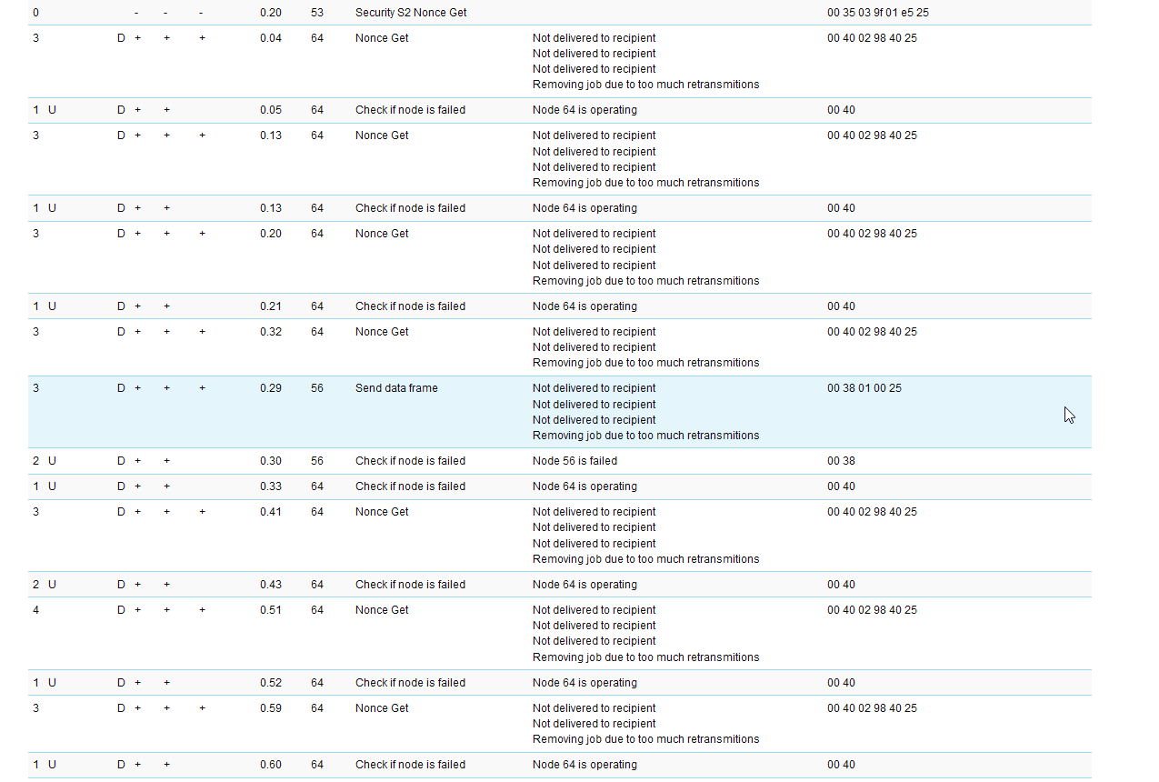

system hangs after few day´s.
2023-07-21 10_02_39-Z-Wave Expert UI – Mozilla Firefox.png (53.13 KiB) Viewed 45373 times

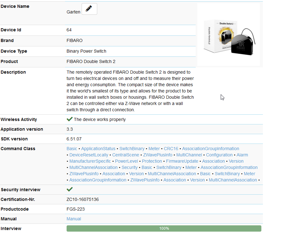

Is seems it was Device ID 64
2023-07-21 10_08_05-Z-Wave Expert UI – Mozilla Firefox.png (71.13 KiB) Viewed 45373 times
Greetings from germany
Jörg

I have 4.1.1 Instaled . Same issue Daily …
For Remote Access i will send you credentials ..
Thanks

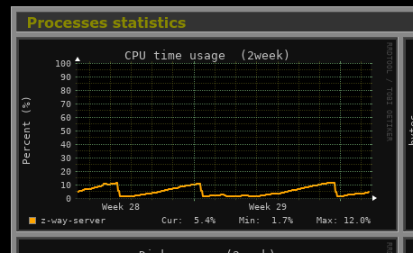

V4.1.0:
Has anybody else the effect with growing cpu load?
Screenshot 2023-07-24 at 09-25-35 raspberrypi Monitoring.png (19.11 KiB) Viewed 45251 times
USER       PID %CPU %MEM    VSZ   RSS TTY      STAT START   TIME COMMAND
root     11293 13.1  8.5 235000 80372 ?        Sl   Jul22 305:55 z-way-server
root     11293  0.0  8.5 235000 80372 ?        Sl   Jul22   0:05 z-way-server
root     11293  0.0  8.5 235000 80372 ?        Sl   Jul22   0:07 OptimizingCompi
root     11293  0.0  8.5 235000 80372 ?        Sl   Jul22   0:12 v8:SweeperThrea
root     11293  0.0  8.5 235000 80372 ?        Sl   Jul22   0:08 v8:SweeperThrea
root     11293  0.0  8.5 235000 80372 ?        Sl   Jul22   0:04 v8:SweeperThrea
root     11293  0.0  8.5 235000 80372 ?        Sl   Jul22   0:02 v8:SweeperThrea
root     11293  8.9  8.5 235000 80372 ?        Sl   Jul22 209:02 zway/core
root     11293  0.6  8.5 235000 80372 ?        Sl   Jul22  14:35 zway/webserver
root     11293  0.2  8.5 235000 80372 ?        Sl   Jul22   4:45 zway/timers
root     11293  3.2  8.5 235000 80372 ?        Sl   Jul22  76:06 zway/dev/ttyAMA
root     11293  0.0  8.5 235000 80372 ?        Sl   Jul22   0:17 zway/sockets

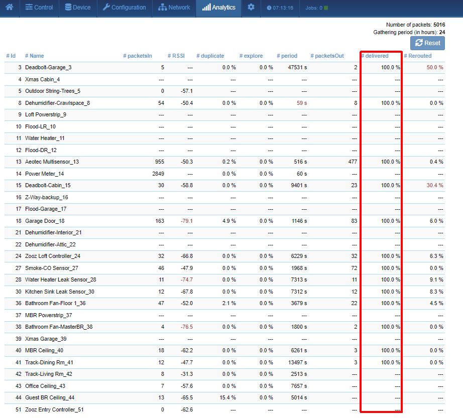

Yes, I see the exact same CPU growth by the z-way-server process (zway/core thread) on my 2 systems running 4.1.0. Since I haven't seen the load exceed 11%, it's not been a serious concern.
Like you, my systems have not experienced the job queue issue. Z-Way reports 100% delivery for all of my devices (as shown by expert ui Analytics->Packets). For users that have the job queue problem, I wonder whether fixing any mesh routing issues so that delivery was 100% would bypass the job queue problem.
packet stats.jpg (123.58 KiB) Viewed 45238 times
