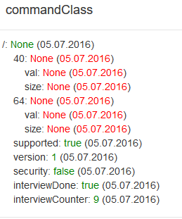

I try to setup the values via Expert UI like this before: https://forum.z-wave.me/viewtopic.php?f=3422&t=23473
Dont work. I get this:
With my old board i can set the values now i can set a parameter but the values are wrong.

Update: Seems that data will be send. Timeline give me Feedback all Data what i need. But Dashboard will not refresh.
CommandClass still red.
