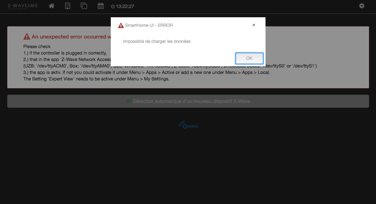

I decided to check in Zway, and everytime I try to add a device I get the famous "Smarthome UI error". It seems like the razberry is not responding.
Capture d’écran 2017-06-14 à 13.22.23.png (88.88 KiB) Viewed 6888 times
Re: Razberry 2 defective?
Why ttyACM0? With RaZberry it should be ttyAMA0
