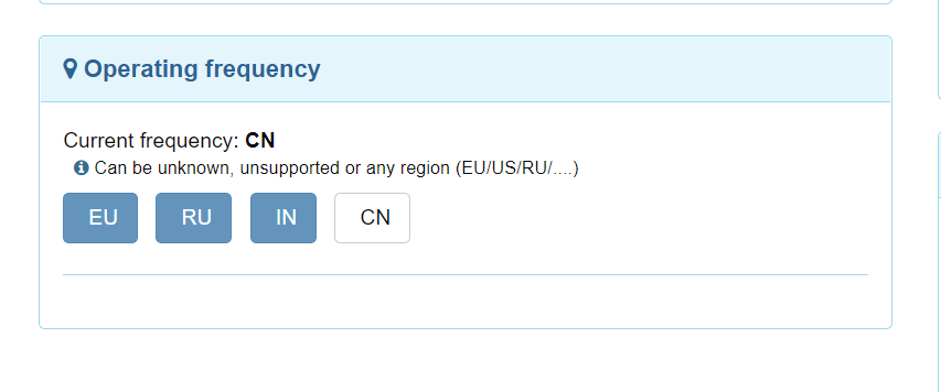

Posted: 07 Aug 2017 13:46
by wavedoff
After upgrading I can no longer select US radio frequency for chipset... It will only allow me to set EU/RU/IN/CN regions...
Can I set operating frequency in a config file somewhere? None of my devices will talk to it now that I cannot set the correct frequency..

Posted: 10 Aug 2017 09:25
by jacksun101
wavedoff wrote: ↑
07 Aug 2017 13:46
Yes, I got stuck just right there too. My RaZberry should be working on US frequency, but now it's only showing those countries like the screenshot.
