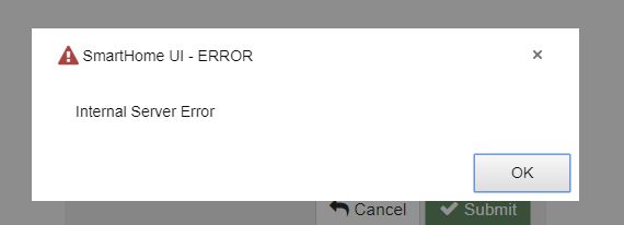

I am revisiting the use of a Razberry that I had setup 2 years ago and have a login issue.
Simple, I am not able to login, attempting to use the forgot password link returns an error.
This was a Popp unit if it's any help.
RaZ error.jpg (7 KiB) Viewed 12693 times
I'm going in circles and need expert help.

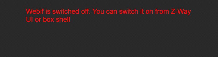

This is the message I get when I try to access through port 8084.
This one is from port 8083
RaZ error.jpg (7 KiB) Viewed 12627 times

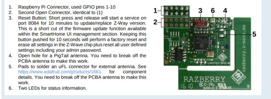

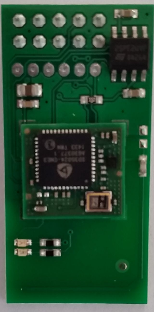

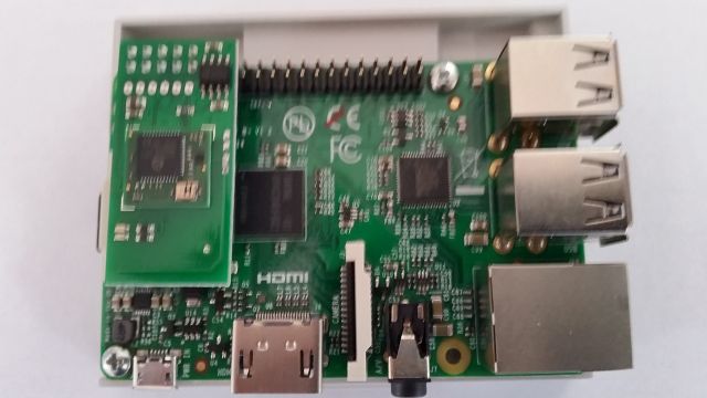

I found this method to Upgrade and ReSet but the board is different.
My RaZ looks like this.
