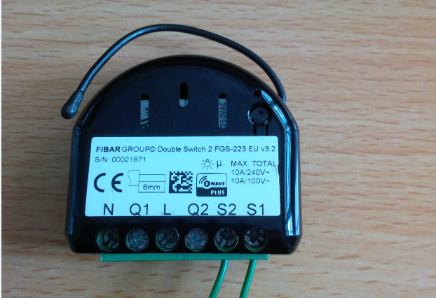

hi you
i'm beginner with z-way me

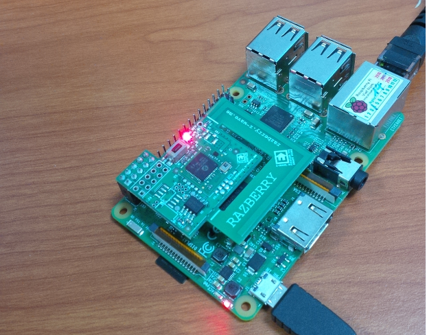

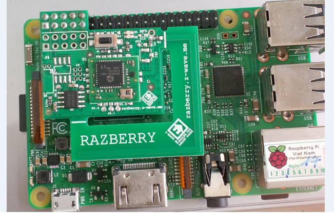

to day i installed z-wave me on raspberry pi 3

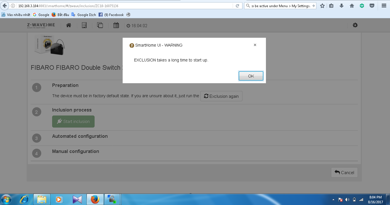

and i try to find Fibaro Double Switch 2 but it have error
I have configured /dev/ttyAMA0 for RaZberry Daughter Card and set fequency is EU but it can't find fibaro swich
so what is my problem and how to fix it?
thanks so much to any help

Re: Fibaro and zway connect
Nothing strange in the log. RaZberry just don't see anything from your Fibaro Switch.
We have seen this with Fibaro FGS/FGD modules - try to do factory reset according to their manual. And then they should include flowlessly.

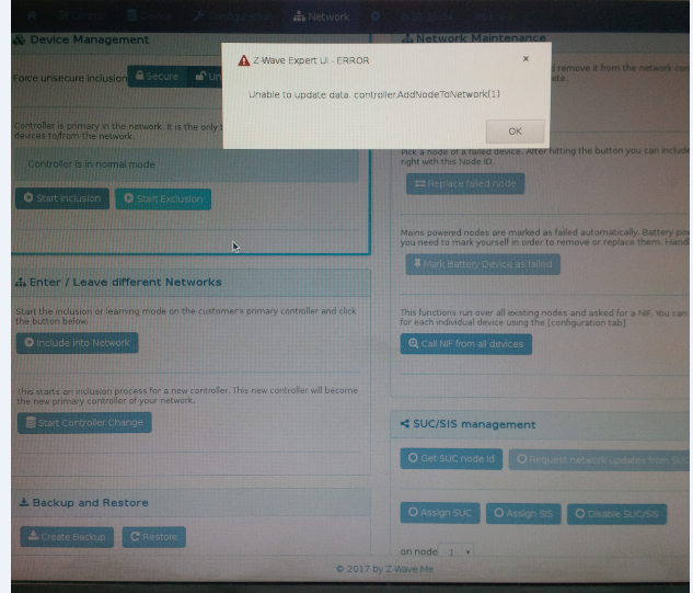

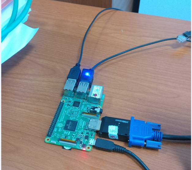

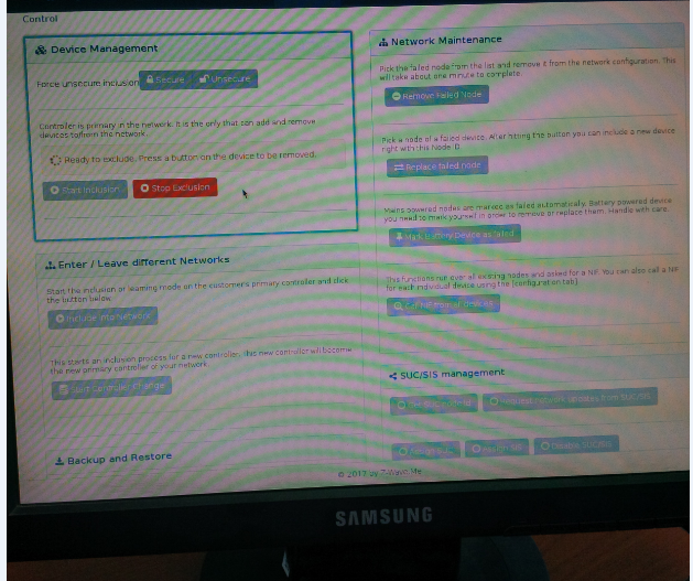

Hi Polto,
I tried again with razberry daughter card but it not suscess and i try with uzb
but when i inclusion device it have error "z-wave Expert UI error : unable to update data controller : addNote To netwwork [1]" and blue LED is not bright
when i exclusion device- LED is bright
i don't know my uzb work ?
and how to my zwave inclusion device
thanks for your help
zwave uzb.png (676.21 KiB) Viewed 15606 times
zwave err2.png (697.19 KiB) Viewed 15606 times
zwave err.png (614.25 KiB) Viewed 15606 times
Your donlge looks to have no license loaded in it. Check controller info page and license button
