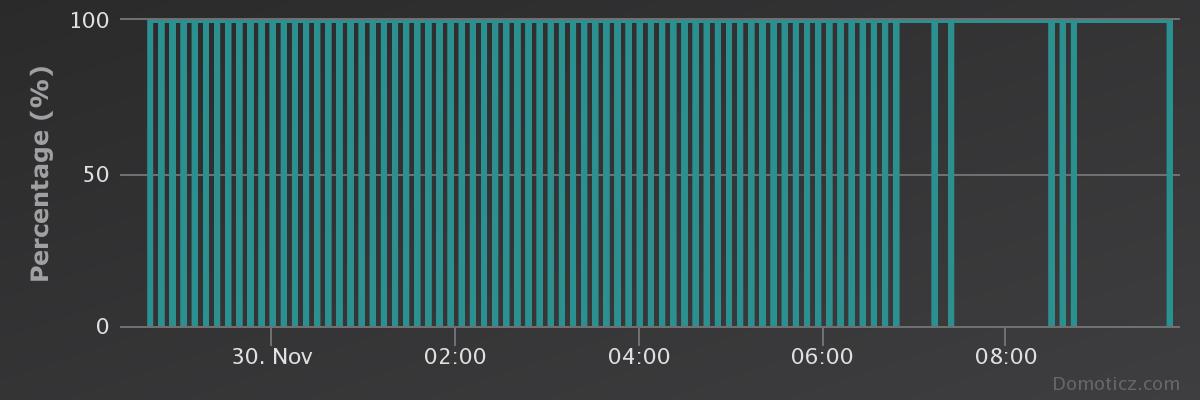

This is the graph for my living-room PIR during last night. You'll see it just kept firing.
Any ideas?

Post by Benny »
Do you have fibaro actors and Sensors? It could bei possible you have an smoke alarm. Most fibaro actors configured to switch the Light on by smoke alarm. That alarm would send by Broadcast, perhaps domoticz do not recordnized?
