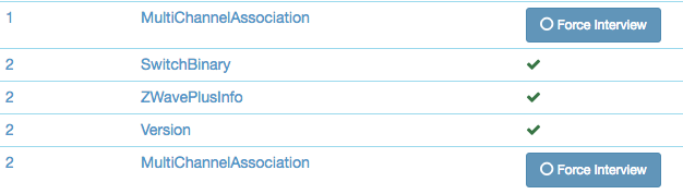

Hello
I have bought Neo Switch like linked below. Interview goes only 90% (I tried 2 different pieces from different packages) - falies on MultiChannelAssociation 1 and 2 (as screen 1).
Additionally Association tab in ExpertUI is empty :(. I can attempt and set manually association using Expert commands but not on Multichannel 1 and 2 and I would like to use it to set light and notify twin switch on 2nd floor. I am attaching XML for it - any advice how to sort it out?
Cheers,
Piotr "Rook"
https://www.aliexpress.com/item/Smart-H ... 68194.html
Screen Shot 2018-01-02 at 21.16.22.png (27.62 KiB) Viewed 6558 times
Re: Problem with dual Neo light switch
Need to see the log, but certainly the device is faulty in implementing this Command Class.
Make sure to use the latest Z-Way
