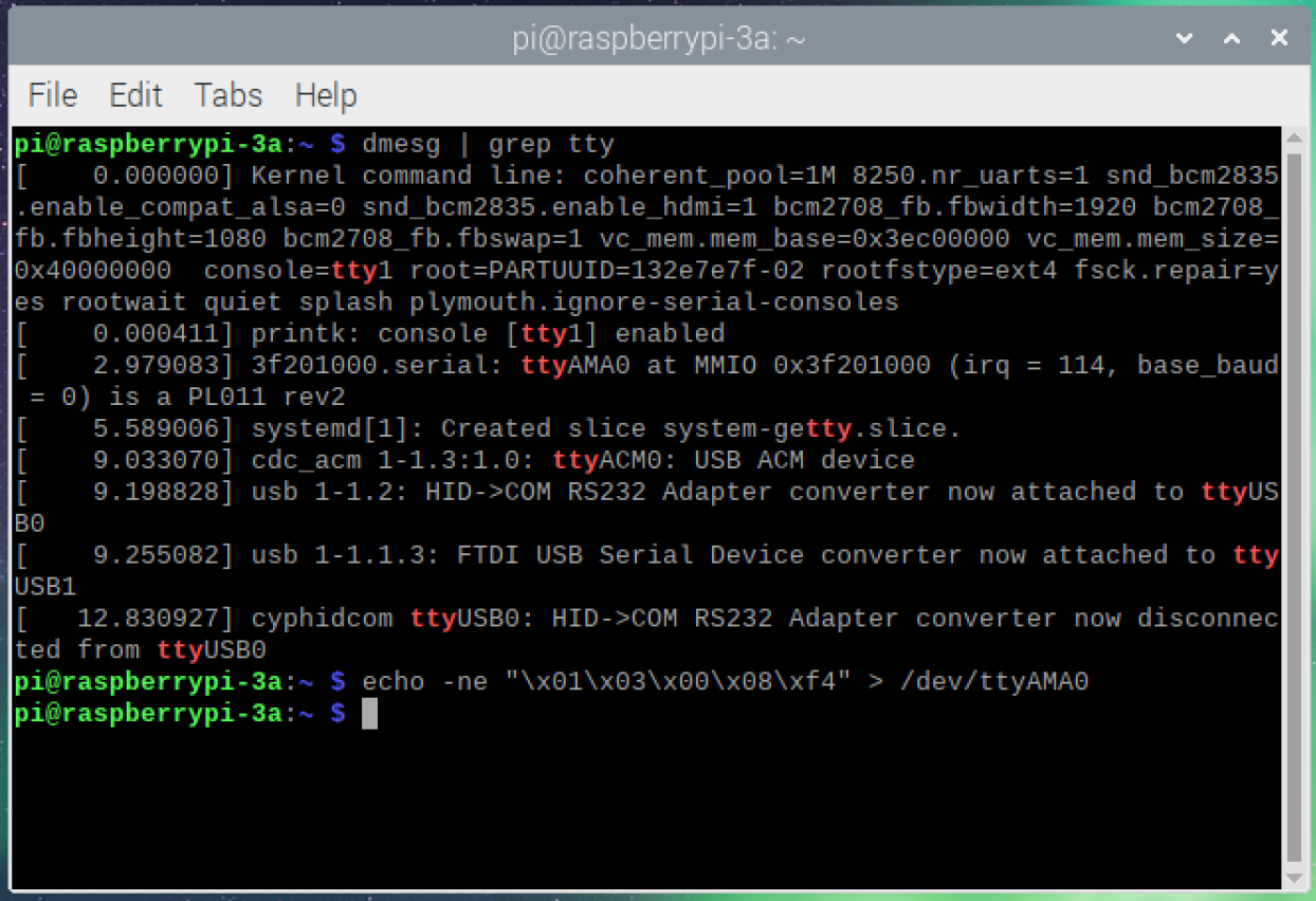

Has anyone tried the Hard Reset below?
echo -ne "\x01\x03\x00\x08\xf4" > /dev/ttyAMA0
I have tried it after my Razberry 5 seized up as from 07:00 am, but it still won't switch anything. Normally I would have to power off the Pi (3) and turn it back on again, as mentioned in other posts, but it would be so much better if I could do this remotely by using a command such as this one.
I also have a Razberry 7, maybe it works for that?
See the screenshot for my commands. I checked to see the serial port first, which seems to be the TtyAMAO one.
Screenshot 2024-09-18 125412.png (482.62 KiB) Viewed 67030 times

A bit of further information. Following running that command, I re-booted the Pi (I did not power it off, just a soft re-boot), and it all seems to work again. This has never happened before, so I assume the hard reset worked, and re-booting the Pi reset the software. I will try the Soft Reset next time after the hard reset, and without re-booting, to see if that works. At least I have a means of remotely recovering from this situation.
