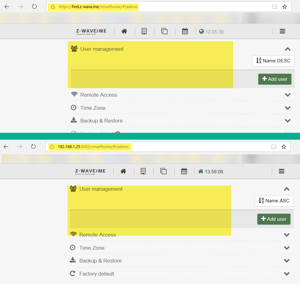

It seems that I can add new users but cannot manage them. They do not appear in the manage UI:
User_Management _No_Users.png (73.58 KiB) Viewed 37465 times

in one of the previous version I had same issue - I checked configuration file and there were duplicated users saved (same name, same ID) - I removed duplicate and it started working.

Please halt Z-Way, open configjson-..... file in /opt/z-way-server/automation/storage and make sure to rename users that have the same login and id.
How have you managed to do it? Have you added users recently? We were unable to reproduce this. May be you remember what you did when this happened?
