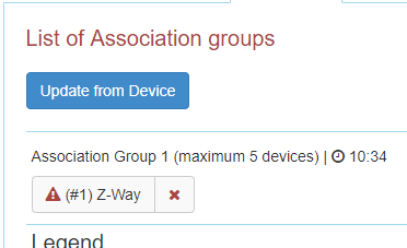

make sure your lock is sending updates to Z-Way. For this it should have Z-Way in LifeLine group (Association group #1)

thanks for the suggestion, but I think it's already in there -
