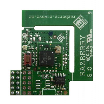

I need to connect an external antenna to this card :
What I did : (cf. schema above)
  1. Solder the core of external antenna to the GREEN hole.
  2. Solder the shield of the antenna to the two RED points.
  3. Cut the built-in antenna like shown by the ORANGE lines
The antenna is a 868Mhz One , frequency used in France, where I live, for z-wave products.
This Does not work …. Did I do something wrong ?

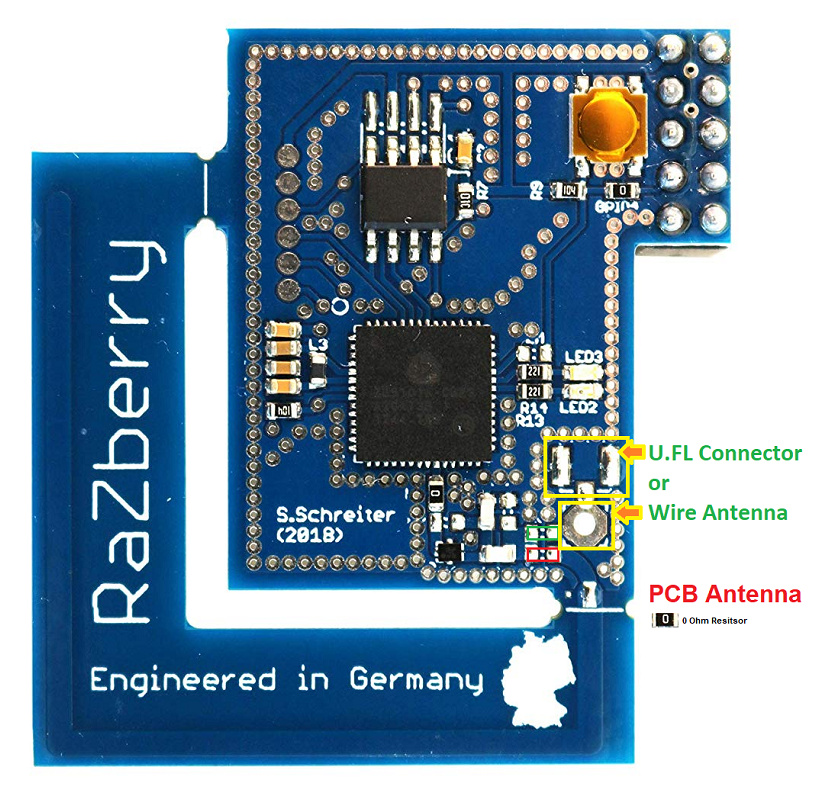

so I had "few" free minutes (with 6month daughter it is not so easy ;)) I found my old ERSA soldering station and I did solder the u.fl socket and also You need to un-solder 0ohm resistor R3 and solder to R4 pads (or just make a tin jumper) (it cut off pcb antenna)
if You did break PCB antenna You only need to do R4 jumper

Hi @ all,
please see the attached image and the instruction further below:
The 0 Ohm resistor is by default soldered on the red PCB antenna contact points. To use Wired Antenna or U.Fl Connector it is necessary to place the resistor on the green contact points.
> Unsolder 0 Ohm resistor from red marked position and solder it on the green marked position.
Wire length for 868 MHz:
λ =34,54 cm
λ/2 = 17,27 cm
λ/4 = 8,63 cm
(length shouldn’t influence the transmission quality, but it’s worth to test which length will give the best solution – start with the longest and reduce the length step by step until you are satisfied with the solution)
