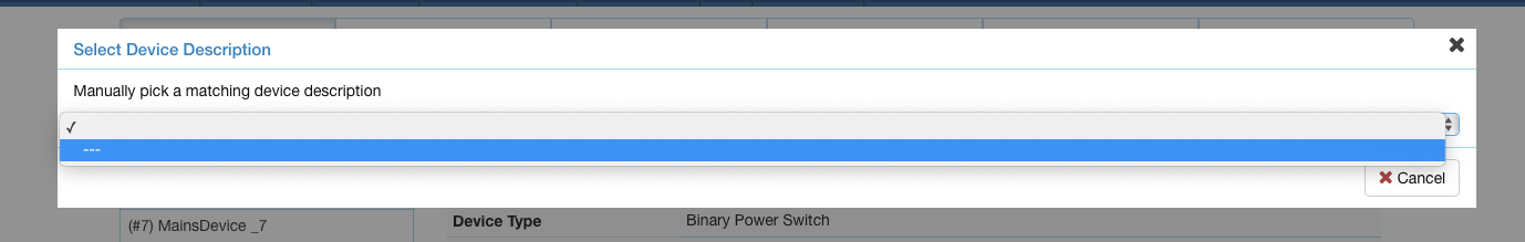

I recently reinstalled my RaZberry, and I cannot get the device descriptions to show up. I am only getting an empty selection menu.
Bildschirmfoto 2019-01-25 um 12.42.13.png (47.38 KiB) Viewed 7363 times
This has happened with a fresh install of Raspbian Stretch with manual installation as well as using the pre-built RaZberry image.
I already tried “Firmware Update -> Update device database”. And I also tried updating the firmware with “Firmware Update -> Open Updater” (which says my current version is v2.3.8-rc4), but this just opens a blank window.
Any suggestions?

Usually this Manu takes 10-15 seconds to load

Thank you, It loaded after 10 seconds. It would be good to show some kind of loading indicator for this.
I have one more issue now: The Fibaro FGS-222 is not showing up in the list. FGS-221 and FGS-223 do show up, however.
Re: Z-Way missing device descriptions
Pick up one of them. There is no big difference
