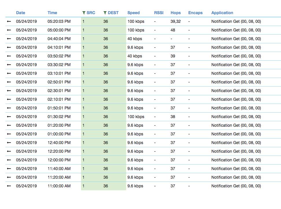

zway is sending "notification get" command to all plugs every 20 minutes, then they will response with some meter/usage reports. is there anyway to disable it? the plugs themselves already have a configuration setting to initiate reporting on an interval.

Hi, did you check the "Periodical Sensor Polling" app, here you can set the time or exclude devices.

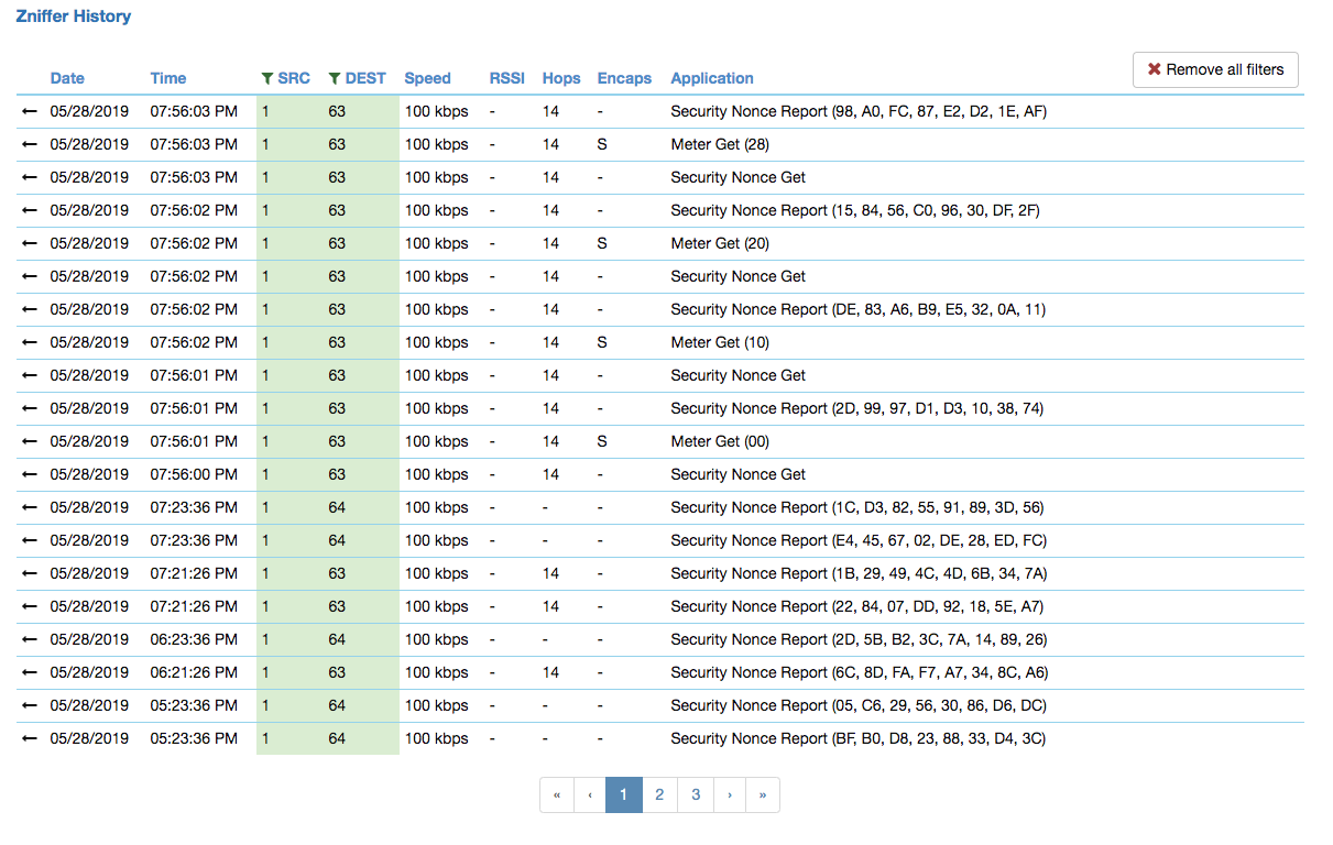

great! i paused the 'Periodical Sensor Polling' app. that completely cleared the the every 20m 'notification get' for most plugs, except for 2. they are some other command class requests other than the simple 'notification get' too. any ideas how to clear those too?
also, is it possible to disable the every 2s 'background noise level' job?
Screen Shot 2019-05-28 at 8.04.15 PM.png (237.17 KiB) Viewed 7966 times

Hmm, do you have some statistics running on your razberry, so the controller 1 trigger this all the time?
What´s the type of product you are using?
