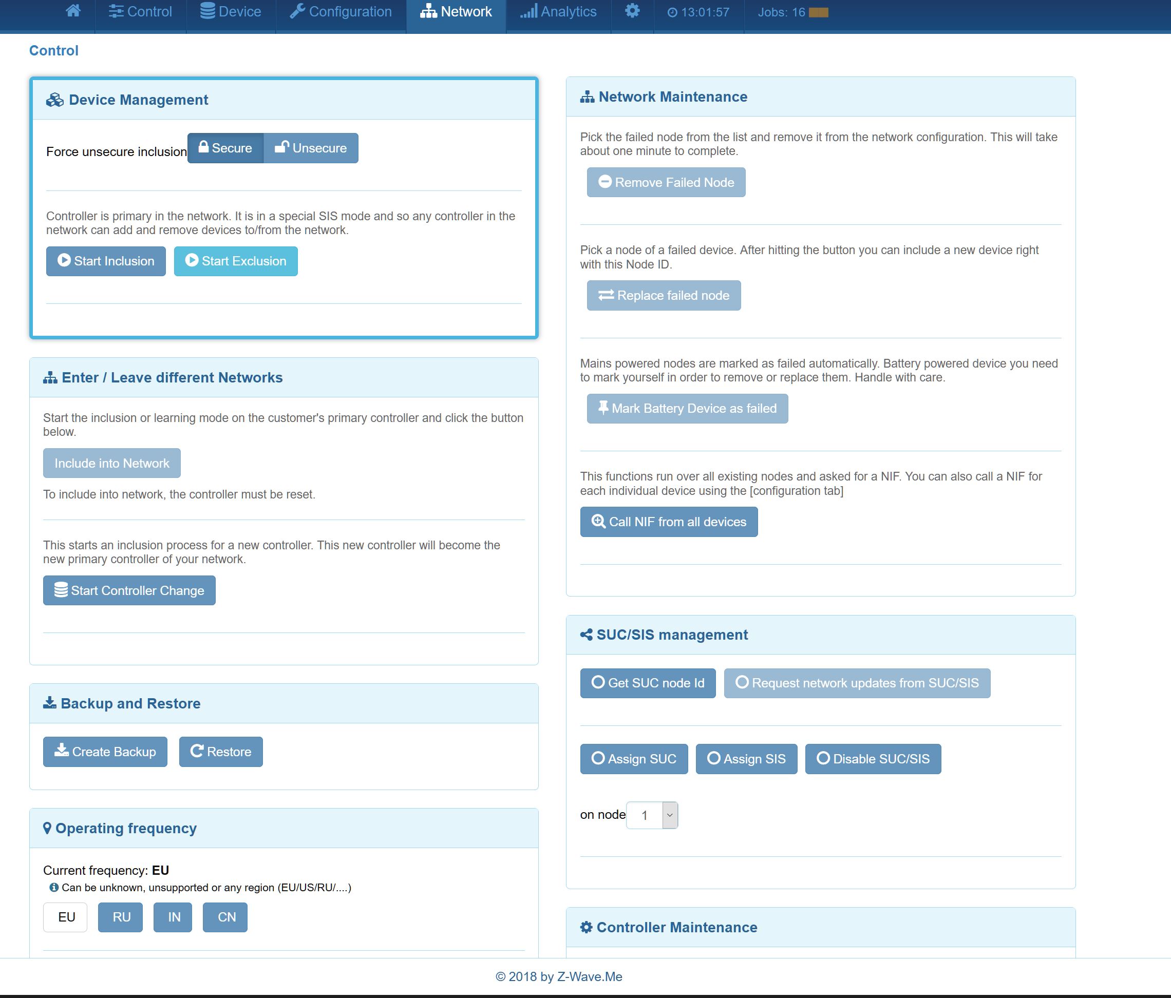

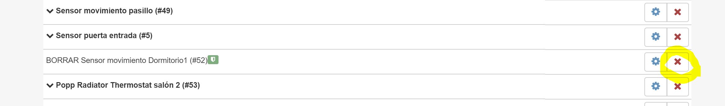

From 8083/smarthome don't working remove either. The problem occurs with any device that you want to remove, in expert the buttons are always disabled and in smarthome let it do it but it does not work, the devices are deleted, but never disapear.

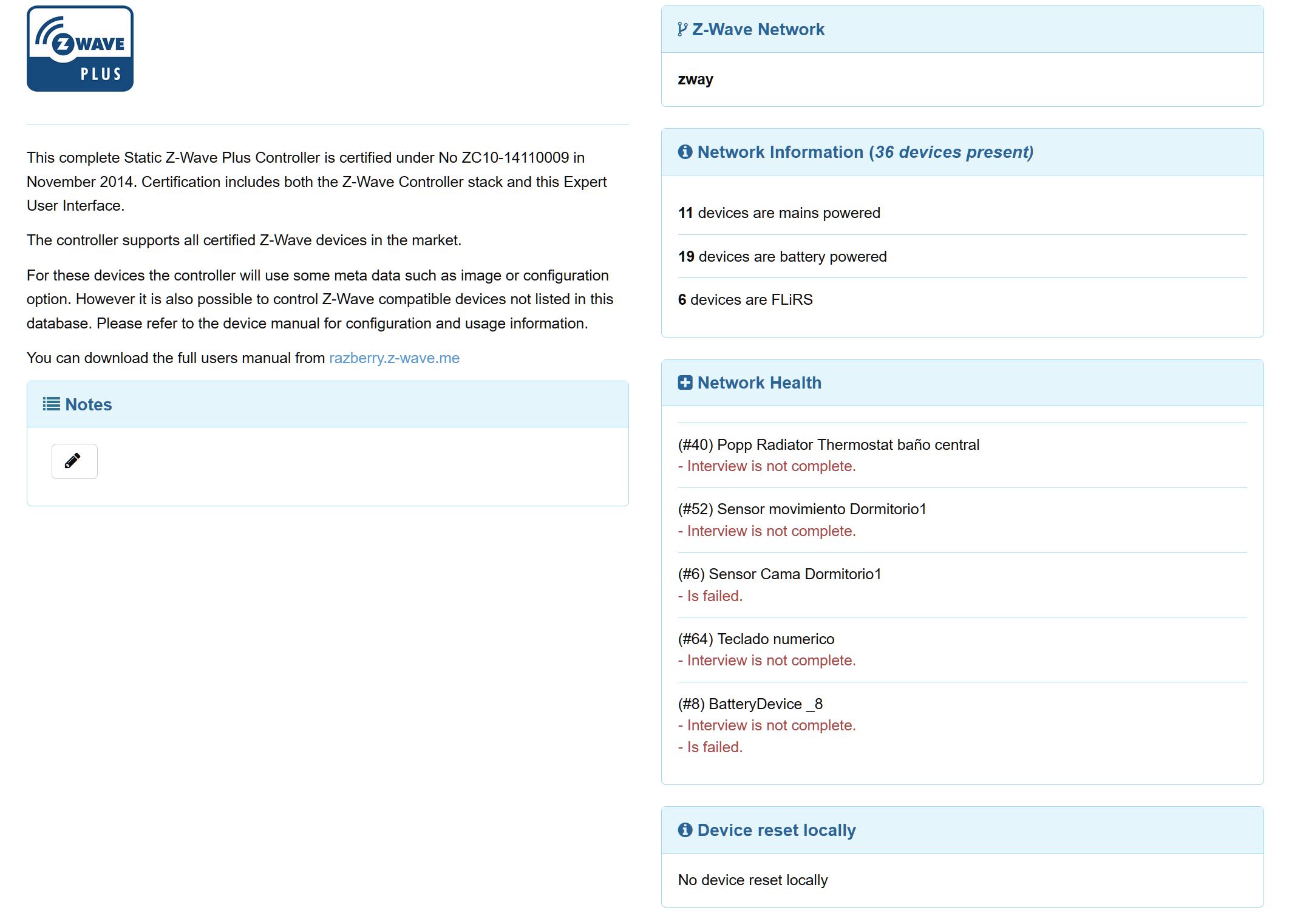

Yes, as seen in the first capture, nodes 6 and 8 are as failed in expert UI. What data do you need for remote access?
