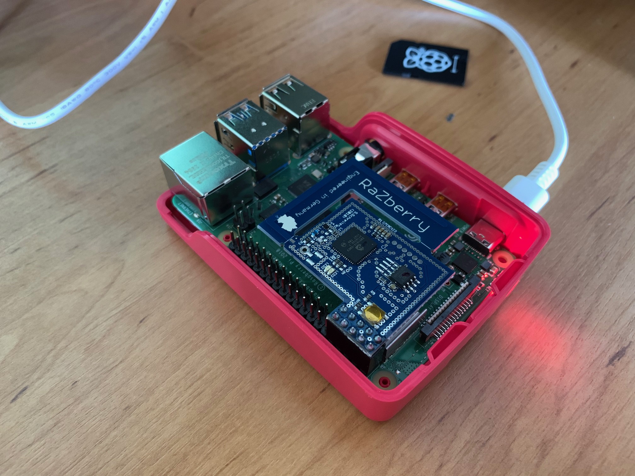

I installed the RaZberry2 at the correct position.

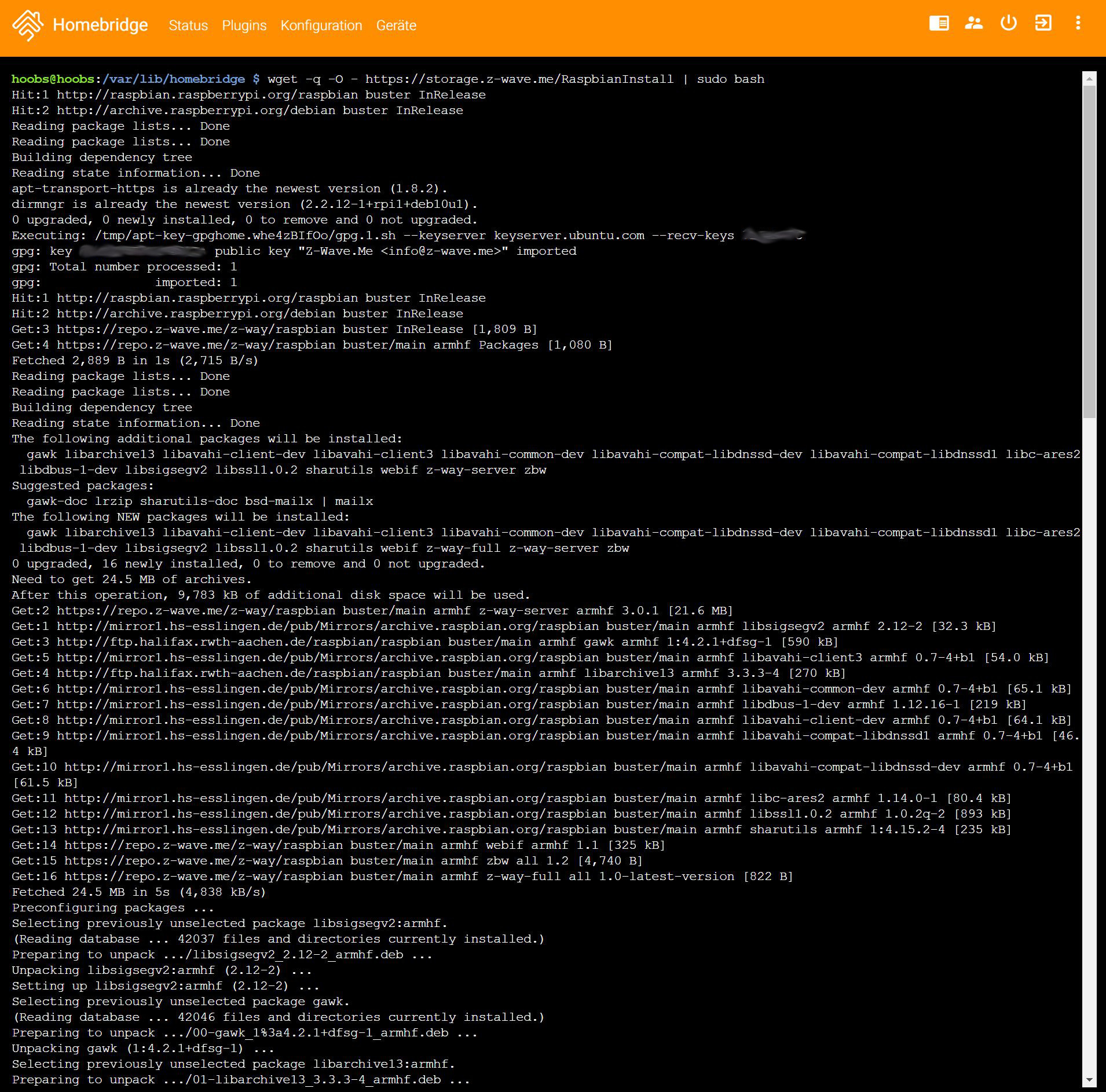

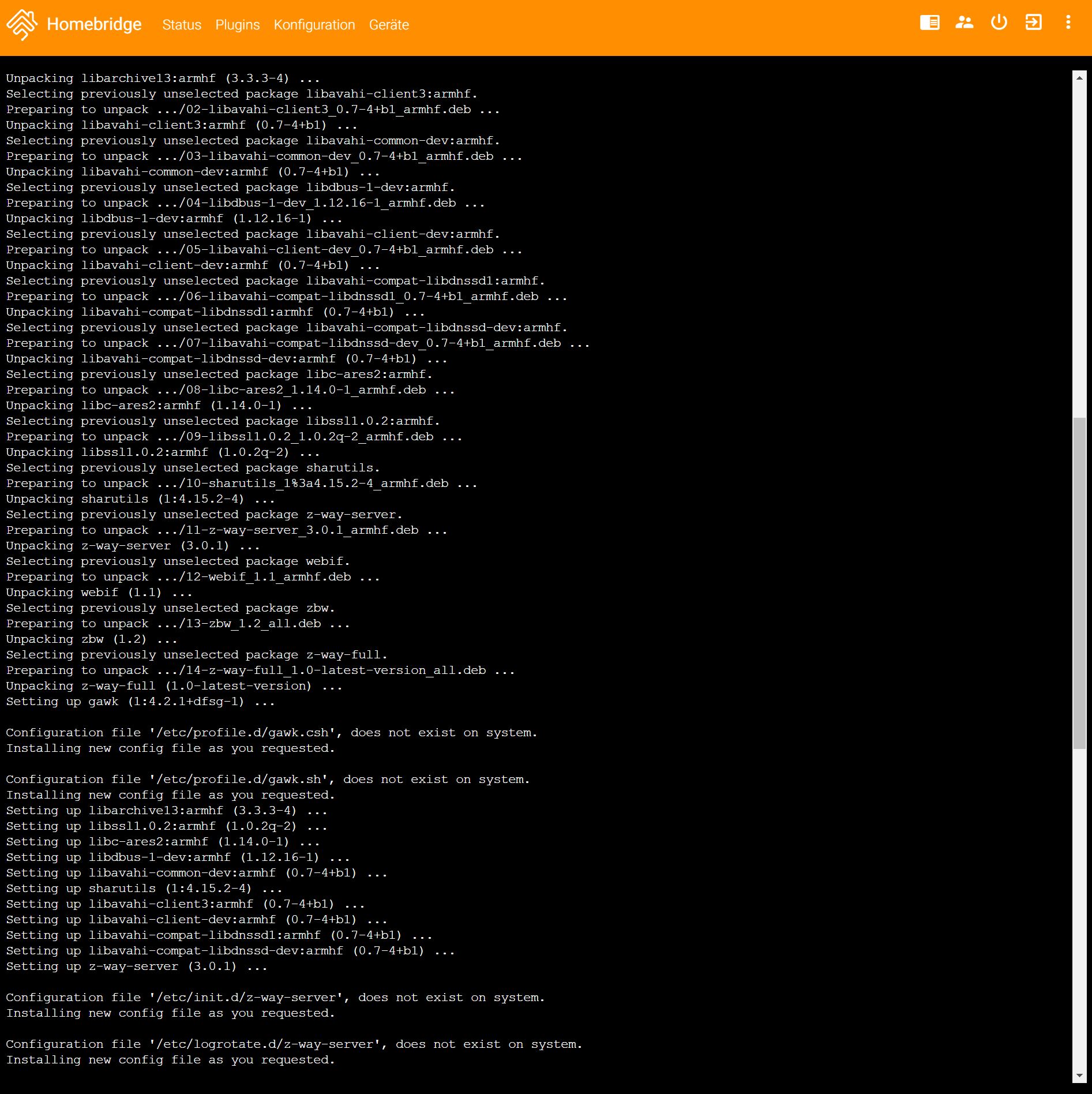

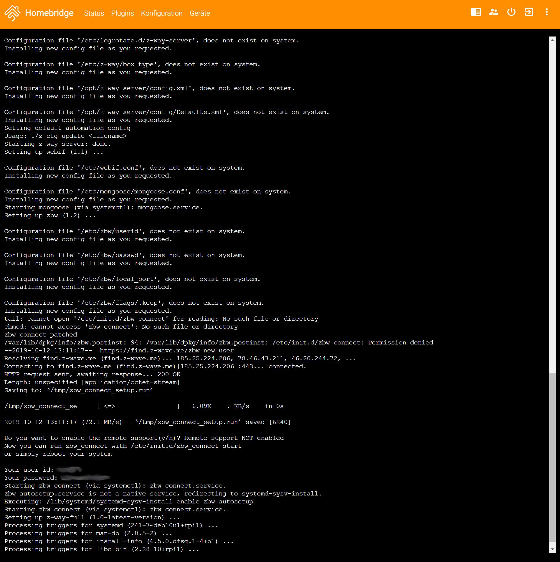

4) I did "wget -q -O - https://storage.z-wave.me/RaspbianInstall | sudo bash"
This is what it's showing there

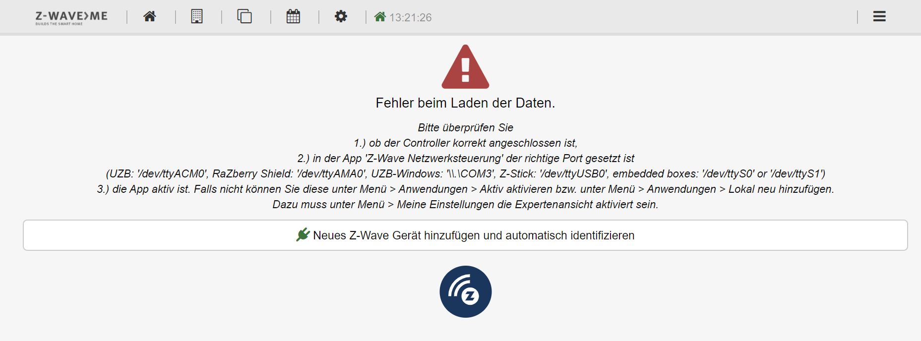

6) When I try to add new devices it shows the following failure.
Which basically means "failure while loading the data" and the possible causes, such as correct fitment, correct port and active app.
And of course the RaZberry fitted correctly, the port is /dev/ttyAMA0 and the app is active.
If I try to add an device it shows a timeout...

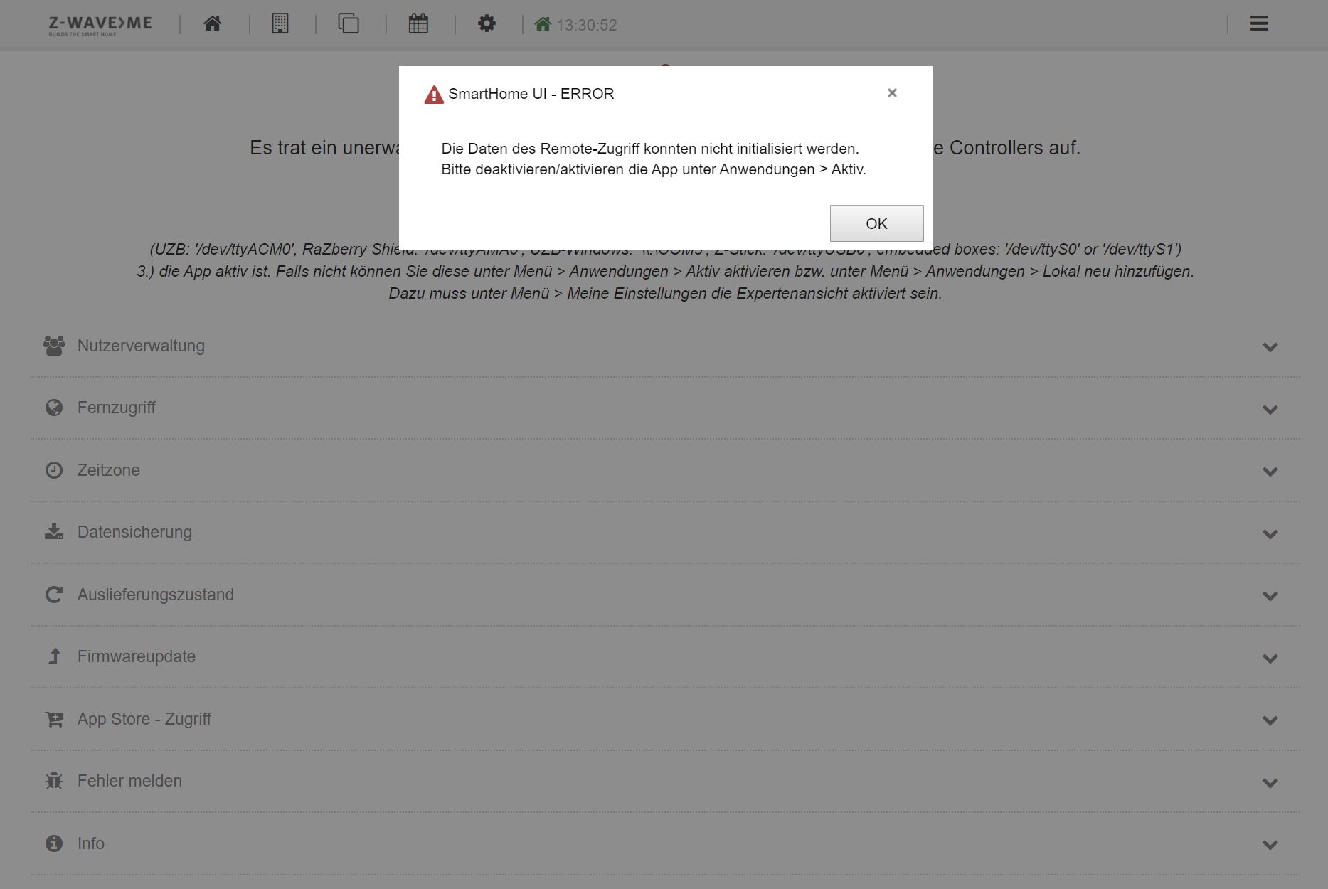

7) Changing to Management shows the following error

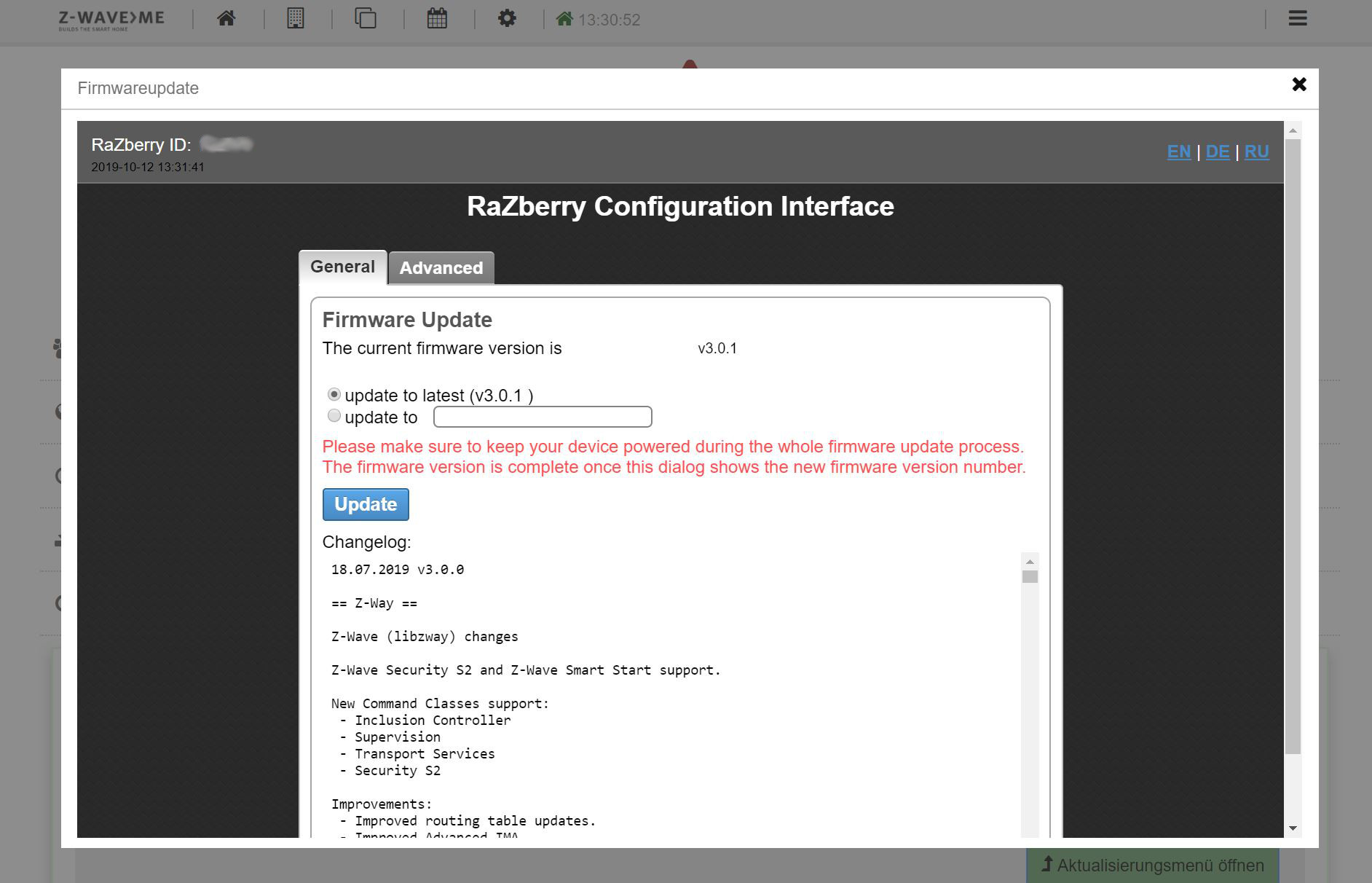

8) Firmware shows that it's 3.0.1

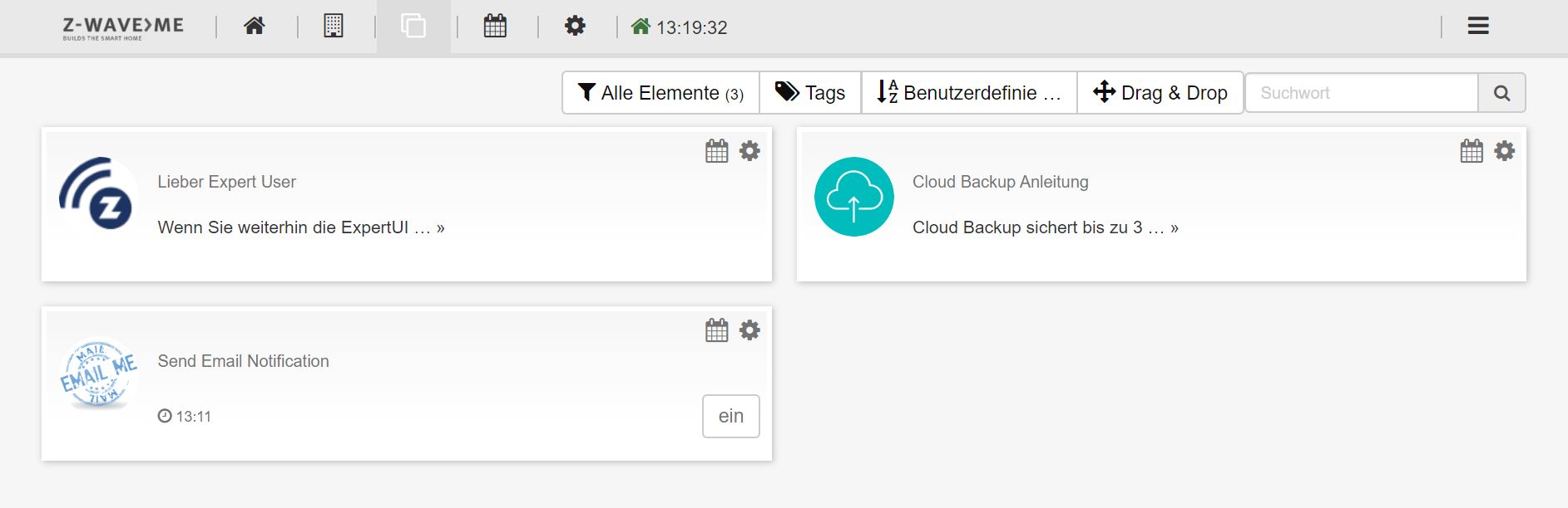

9) Changing to expert ui shows

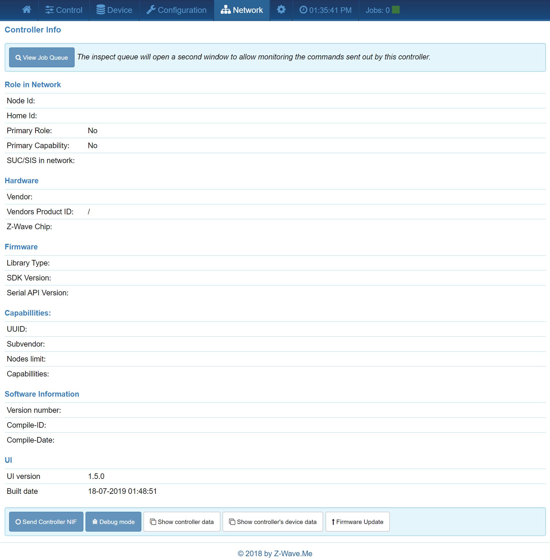

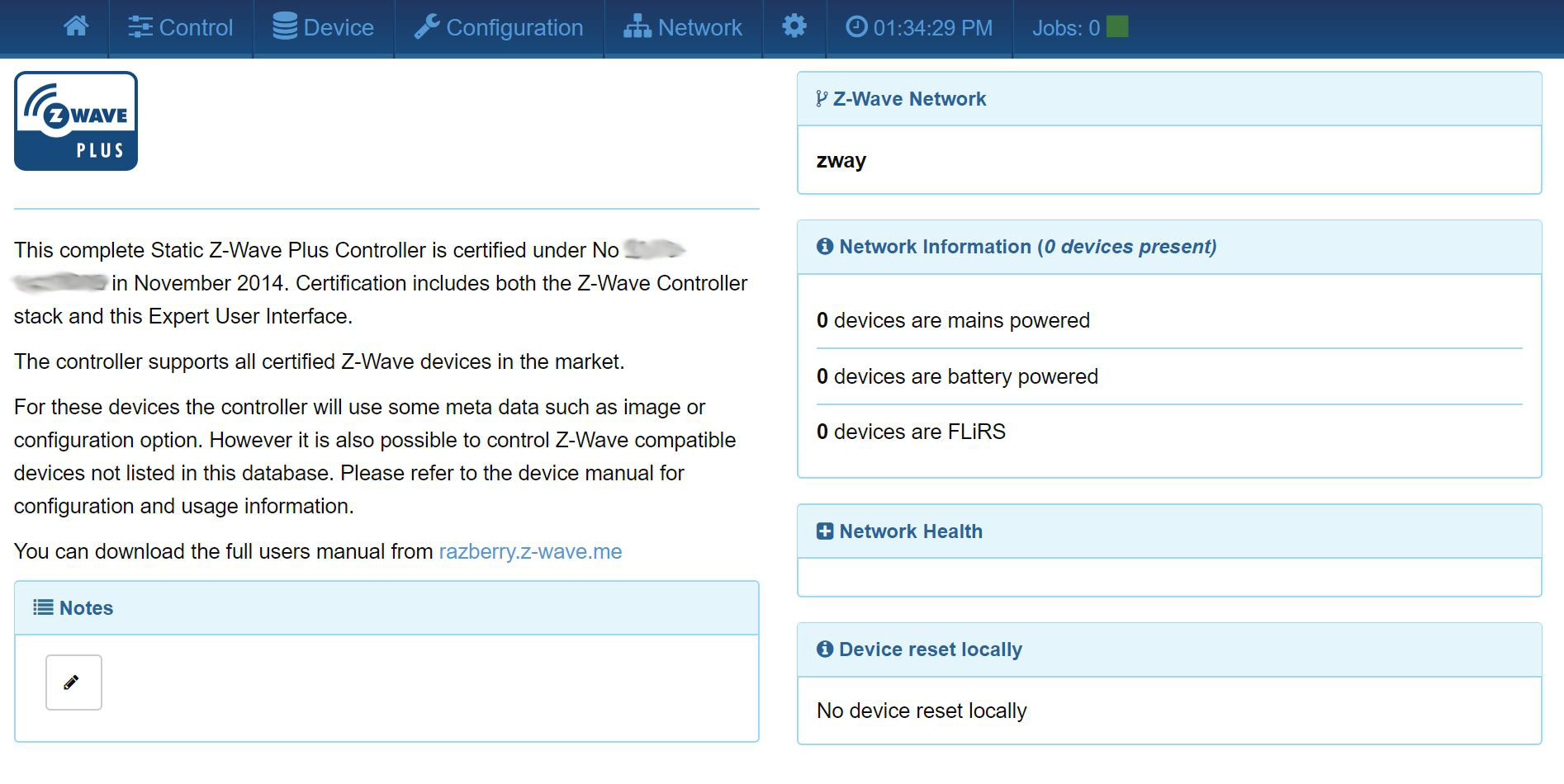

10) Controller Info shows

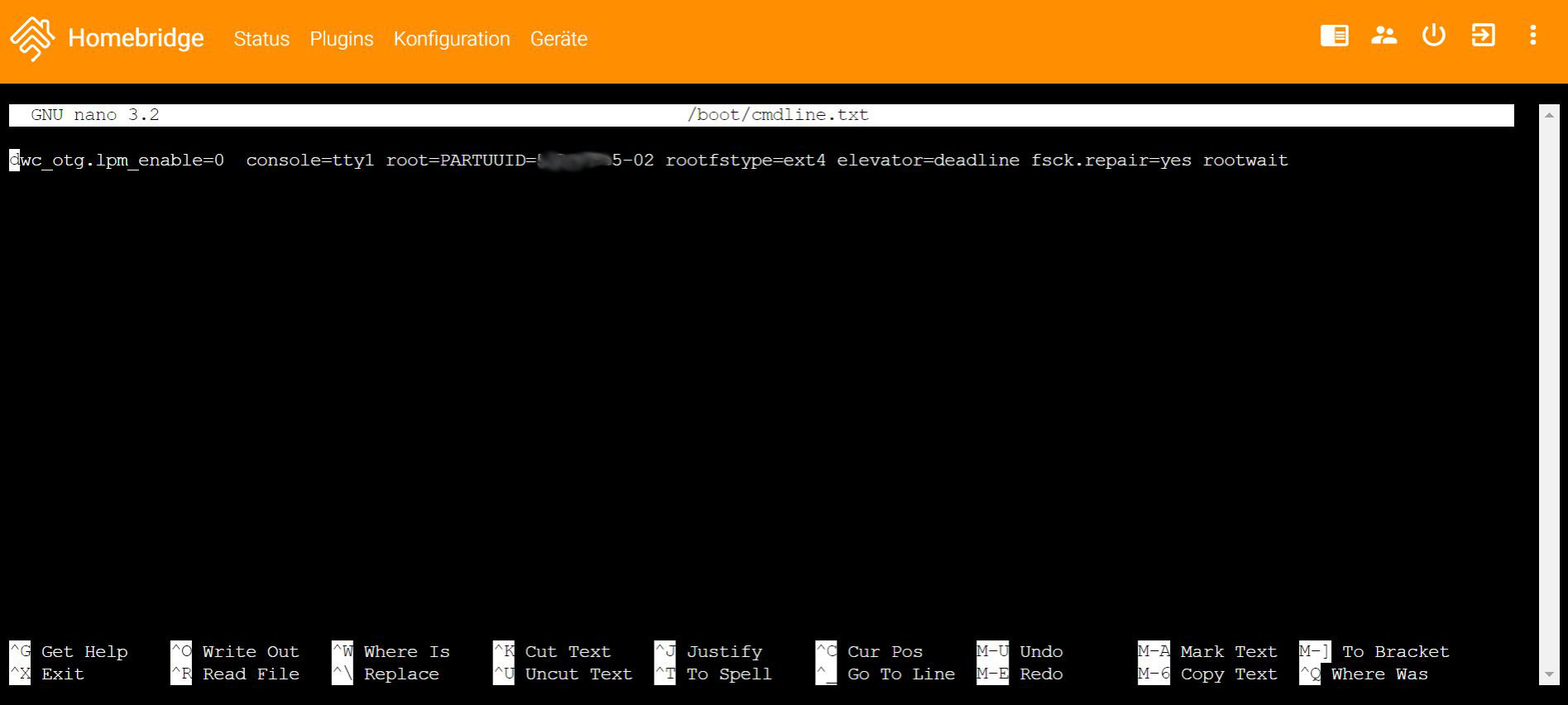

11) If this is somehow important. "sudo nano /boot/cmdline.txt" shows the following
Can you help please ?

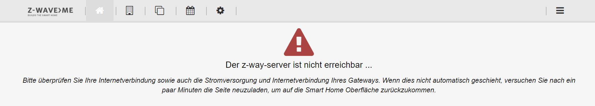

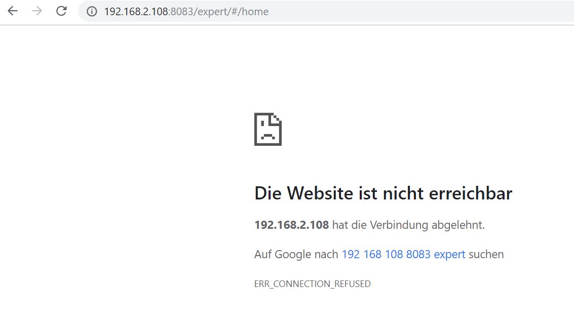

I've made the changes, but now I don't even get into the UI, even when deleting the two lines.
On the standard UI it says "the z-way-server is not available"
See below
