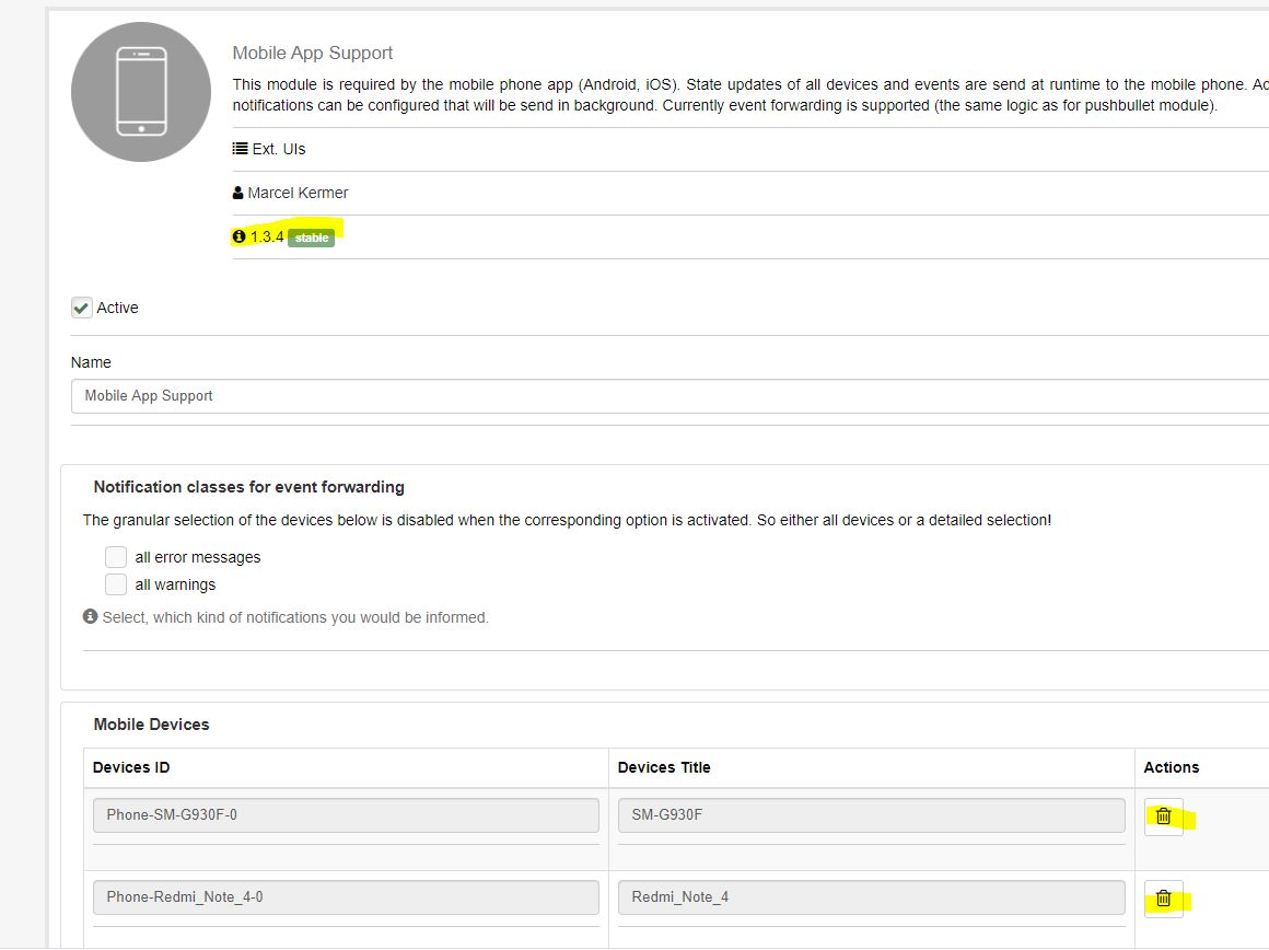

I found out that the app "Mobile App Suppport" on my running system is on version 1.3.4
Its impossible to delete any connected mobile devices with the delete button in this app.
On a clean installation the actual version is 2.0.0. If I restore my system, the version of this app changes to 1.3.4 without any update chance. :roll:
In my running system it is not possible to update the app. When in deinstall the app and reinstall again it is still 1.3.4 and all the old devices are still there.
Does anybody know how to get delete all the old stuff (old version of mobile app support and my old connected devices) without reinstalliing my complete system and enviornment?
A clean installation with restoring I tried allready. It restored the the 1.3.4 app with all the old devices without any chance for updating or deleting.
There must be a file oder folder anywhere on the raspian where all this informations are stored. But I dont know.

Do you see a chance to update my old 1.3.4 version of this app to the new 2.0.0 or newer version without installing everything new? Im my existing installation/System the app is old but there is no offer for an update. The problem was and still is that I cant add or delete any mobile items. Everything is greyed. I works now, but new mobile devices have no chance to be included.
Re: Remote Mobile Access Problems
Sorry, probably I don't get you. Please explain in more details and show screenshots. What is 1.3.4 and 2.0.0?

The problem is the not actual app called "mobile app support" (see screenshot). this version is an old one (1.3.4). An update isnt possible. Why?
The problem with this old app version is that I cant delete old mobile devices like you can see in the screenhot. Adding new devices is also not possible.
