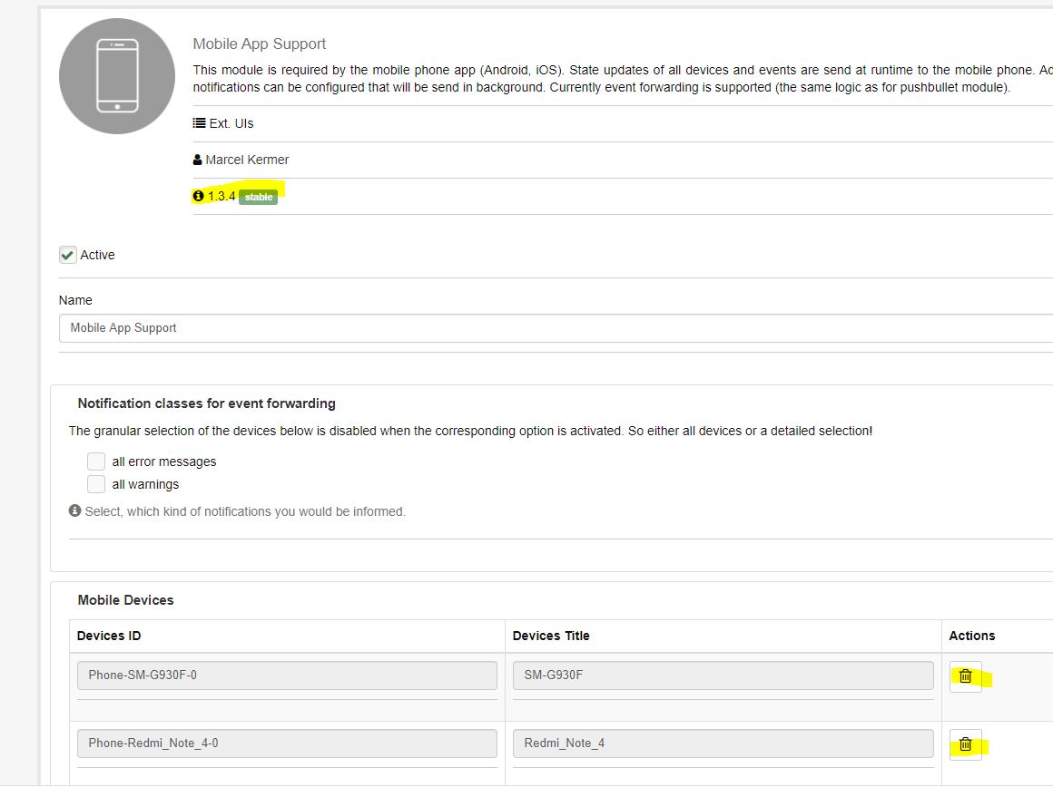

Do you see a chance to update my old 1.3.4 version of this app to the new 2.0.0 or newer version without installing everything new? Im my existing installation/System the app is old but there is no offer for an update. The problem was and still is that I cant add or delete any mobile items. Everything is greyed. I works now, but new mobile devices have no chance to be included.

Sorry, probably I don't get you. Please explain in more details and show screenshots. What is 1.3.4 and 2.0.0?

The problem is the not actual app called "mobile app support" (see screenshot). this version is an old one (1.3.4). An update isnt possible. Why?
The problem with this old app version is that I cant delete old mobile devices like you can see in the screenhot. Adding new devices is also not possible.

I have a similar problem. I don't know why, but I can't manage devices :-(
