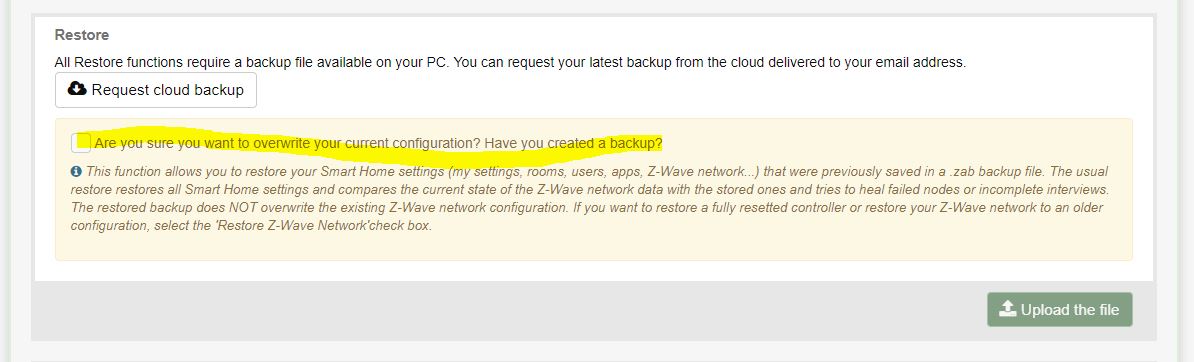

After having some problems with my 3.0.3 zway system on my raspberry (for example zway server not reachable after security alarm) I decided to restore my system from a 3.0.2 sd card image. After that I made the update zu 3.0.3 again. Still the problems, so I decided to use the restore funktion (see screenshot) with the option "Are you sure you want to overwrite your current configuration? Have you created a backup?" checked.
Maybe this was an error.
Now I have the problem that after starting z-way no items (sensors, sirens and so on) are visible and I found the message: "Cannot start Z-Wave binding: Error: Binding with name 'zway' already exists".
I there any chance to heal this without a factory reset?
