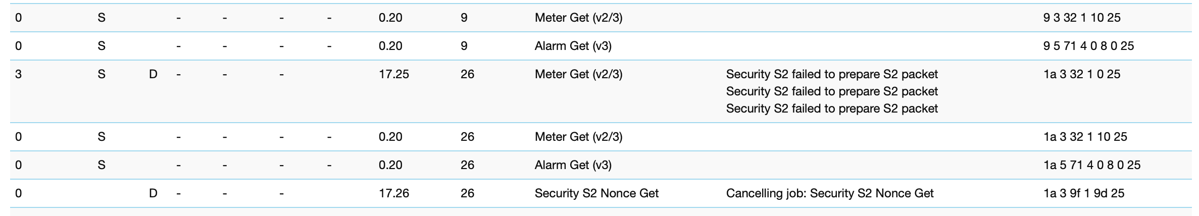

By analysing the logs, it looks like the razberry is waiting for a reply on the "S2 Nonce Get" command, but never gets it when the module is on "Is Failed" state.
When I trigger an interview when the module is in failed state, and explicitly ask SecurityS2 interview, you'll see the request command being scheduled again:

[2020-06-12 08:46:56.057] [D] [zway] Security S2 send timeout event
[2020-06-12 08:46:56.059] [zway] Job 0x13 (Secure S2 NIF Get): Security S2 failed to prepare S2 packet
[2020-06-12 08:46:56.071] [zway] Job 0x13 (Security S2 Nonce Get): Cancelling job: Security S2 Nonce Get
[2020-06-12 08:46:56.072] [zway] Removing job: Security S2 Nonce Get
[2020-06-12 08:46:56.074] [zway] Adding job: Security S2 Nonce Get
[2020-06-12 08:46:56.076] [D] [zway] Security S2 send timer set to 100.000000

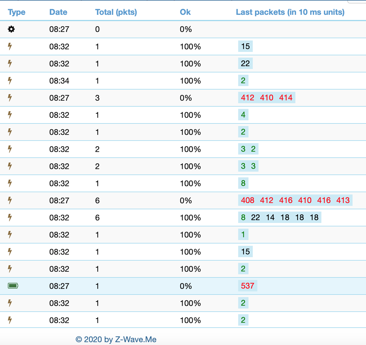

I had to wait a bit for one of the devices to go into failed state again, currently have 2 in failed state.
I checked the logs for any incoming packets to the controller when hitting the switch button (turning lights on / off or dimming), no incoming packets what so ever, although when you check the "timing info" in expert interface, it shows about 4 to 6 (Depending on the device) of packets that were received, not OK though, and with a ~400 * 10ms packets delay.
Screenshot 2020-06-26 at 08.39.34.png (174.29 KiB) Viewed 16990 times
Might be an indication as to the routing not being optimal?

Re: S2 Qubino Mini dimmers randomly go to "Is Failed"
Timing info shows sent packets. Red means undelivered, so your device never got it.
Looks like a device issue. If it does not answer, you can not do anything. Please contact Qubino support and show them logs and screenshots. They are familiar with Z-Way
