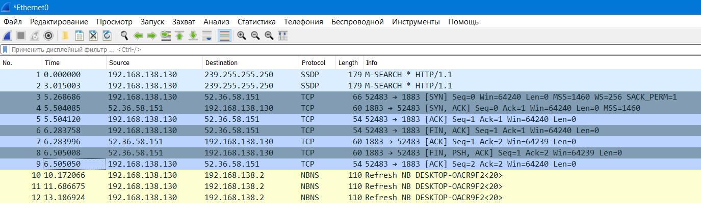

I'm seeing the same thing on newest builds of z-way-server, basemodule, and mqtt. Here are logs for:
z-way-server
on the broker, a repeat of a new connection that immediately fails

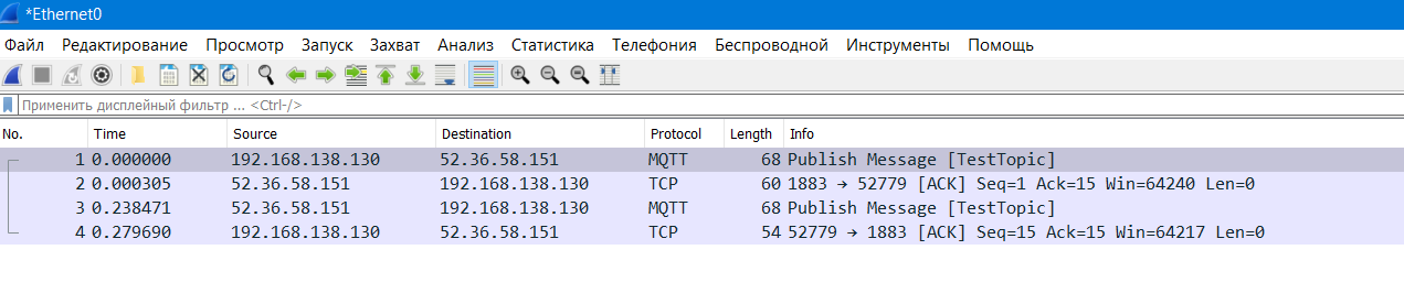

After restarting Z-Way MqttClient works well for me:
I think the problem occurs when MqttClient doesn't close the socket after reloading the instance.
[2020-11-02 18:54:26.436] [I] [core] Instantiating module 41 from class MQTT
[2020-11-02 18:54:26.438] [I] [core] --- Starting module MQTT
[2020-11-02 18:54:26.498] [I] [core] Executing script: /*** Buffer ******************************************************************* ...
[2020-11-02 18:54:26.502] [I] [core] Executing script: /*** MQTTClient ************************************************************** ...
[2020-11-02 18:54:26.538] [I] [core] [MQTT-41] Socket connection opened.
[2020-11-02 18:54:26.539] [I] [core] [MQTT-41] Connected to localhost as zway
