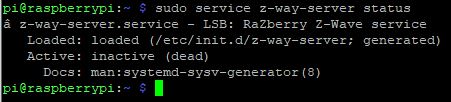

First I found out it is because the most of the time the z-wave-server is dead so I cannot call the WebUI at all.

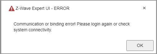

When I restart the service I can log in but then I get a communication or binding error
Can anyone tell me how can I get the Expert Ui working so I can try to include the device via this UI to see if it works.

You need to run z-way-server. Interesting to know why it becomes inactive in your case. Can you show list lines in the log when it stops? May be even running it in gdb

In the meantime I think I know it became inactive all the time: I assume it because of domoticz. When domoticz is started it accesses all the nodes via z-wave.me and thus kills the z-wave-me-server. I assume only one can have access to it because when I manually start z-wave-me-server all nodes disappeare from domoticz and it crashes.
As I can include devices again via domoticz, this issue is solved for me.

Ahh, you have not mentioned that you use domoticz. Of course they battle for the same port if RaZberry.
