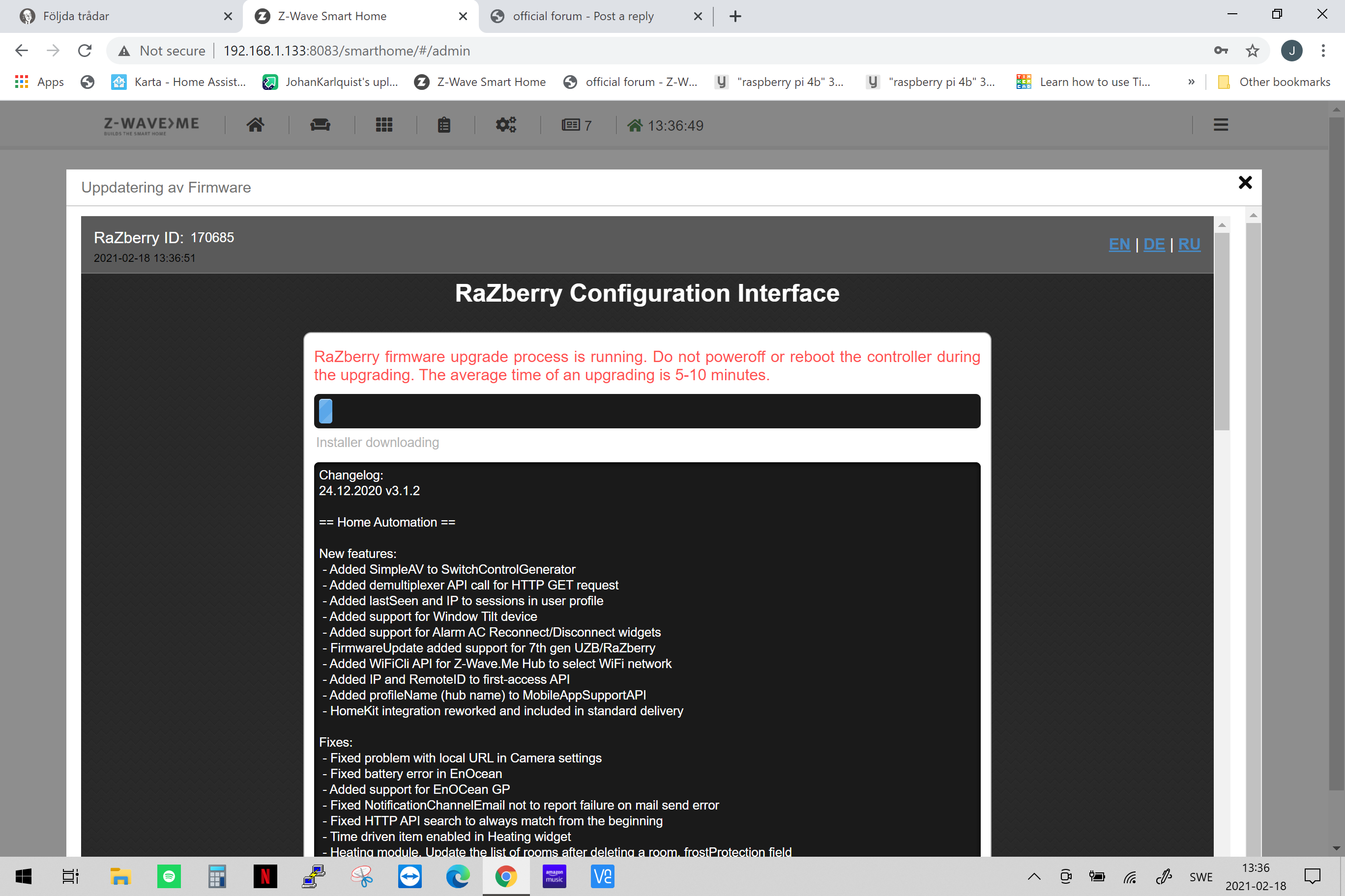

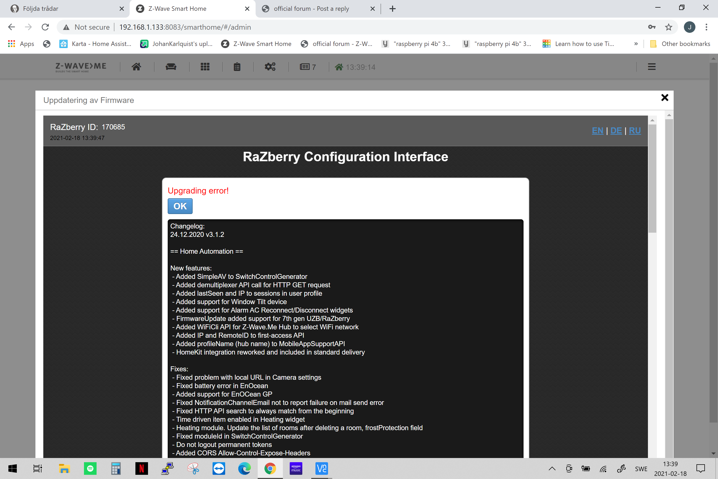

if clicking update to latest it hangs,
if clicking update to v3.1.3 i get update error.
Skärmbild (20).png (513.91 KiB) Viewed 12027 times

seiken
Posts: 32
Joined: 23 Jan 2021 00:54
Re: 3.1.3 - YEZZZ i saw it released
Post by seiken »
update from os side Works
