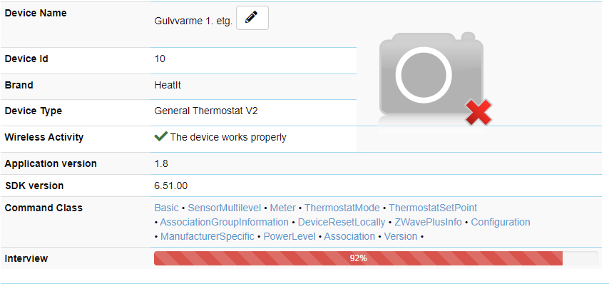

I'm on a fresh install on a RP 3. Installed and tried to include my device. It's a multireg TF016 thermostat on P-mode. It includes to 92% (fails on meter) and says it's working. Reporting stuff, but it's trying to set a temperature, not a power level. How can I change the mode in Z-wave?
I also tried flashing new firmware and bootloaders. Was on 5.4 on both initially. Updated to 5.17 and then I tried to get to 5.22. My bootloader went to 33251 and I'm stuck at fw 5.22. How do I move on?

It's neither. It's the first one I think. It's just called thermostat as you can see here https://manuals.heatit.com/.
Which FW do I use to regress to 5.17? Which one to get to 5.27? It was super confusing with the map with the FWs.
Cant' attach logs. Invalid files .log or .txt. No errors when I search for errors in the log.

Please pesss Interview Results. Try to force the one which is not done.

I've done it a few times. Also removed it and added it again. The meter function won't get ticked.
Re: Heatit/Multireg thermostat not working
May be a device malfunction. The SDK it is based on is pretty old - looks like and old version - may be worth to update (but looks it does not support firmware upgrade - too old one)
