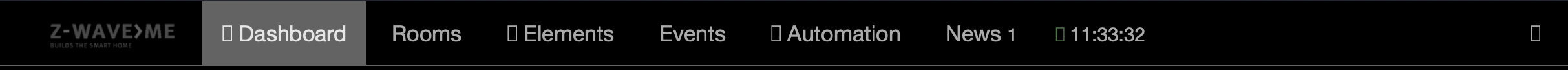

- The icons on the z-way site are missing (see screenshot). Took me some time to find the settings button, but the missing icons are not really an issue for me.

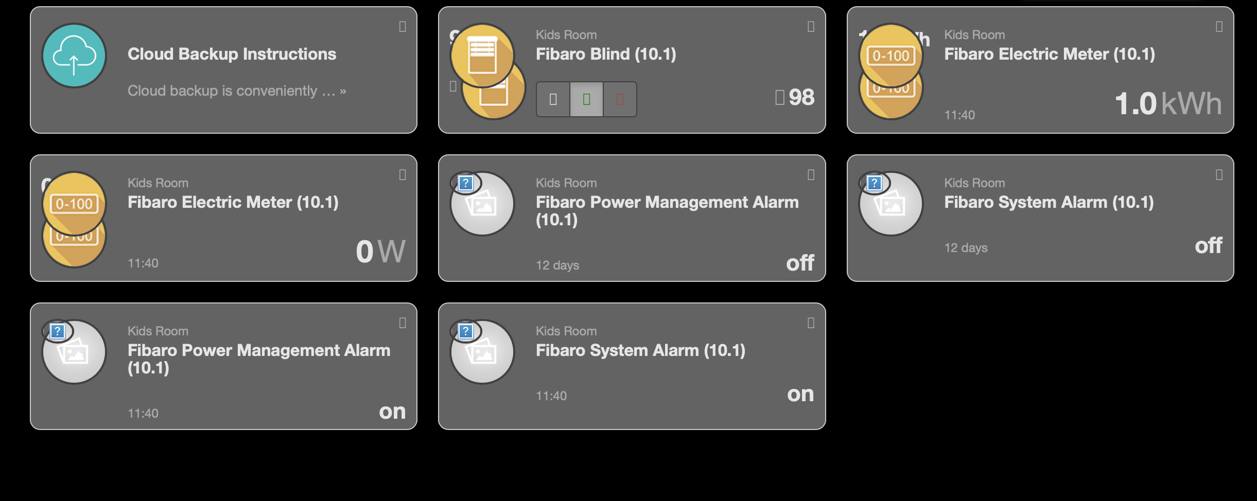

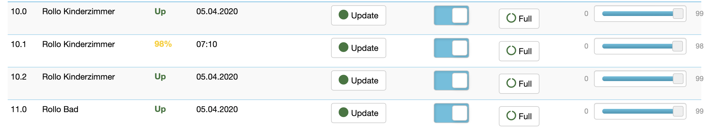

- by including the roller shutter, I always get more than one device, which can be controlled (see screenshots). It's always x.0, x.1, x.2 and adds some more devices. It quite annoying to turn them off, so they are not displayed in the home app.
