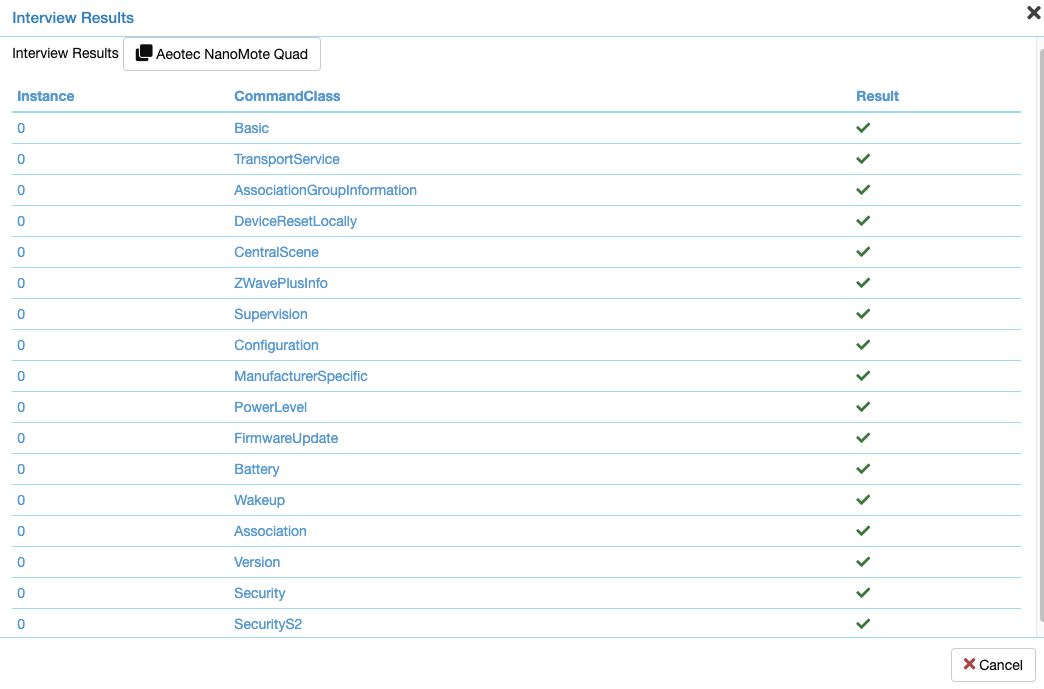

Hi, I've got RaZberry 3.2.1 (app 1.3, sdk 6.71.01)with firmware 5.39 working fine with the Aeotec WallMote Quad (hereafter WMQ), but I've just bought a Aeotec NanoMote Quad (hereafter NMQ) which includes, but then fails to talk. I opted for the S2 unauthenticated during inclusion, and the initial interview seemed to work just fine...

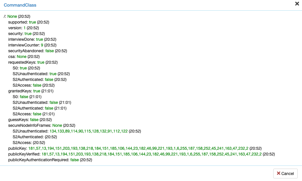

However, after inclusion nothing happens. Zniffer doesn't see any further communitcation. I'm wondering if the device didn't honour my request for no unauthentication?

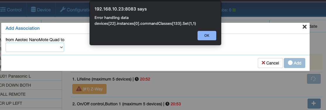

I also note that the WMQ installed a Lifeline association to Z-Way, but there is not such association with for the NMQ. Indeed, if I try to add one, I get an error ...

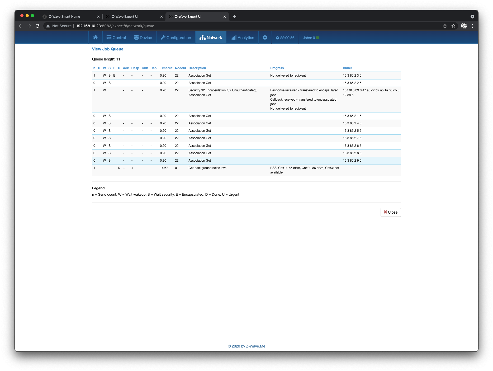

The controller queue seems to be stuck waiting for stuff, even when I put the device into "Long Wakeup" mode...
