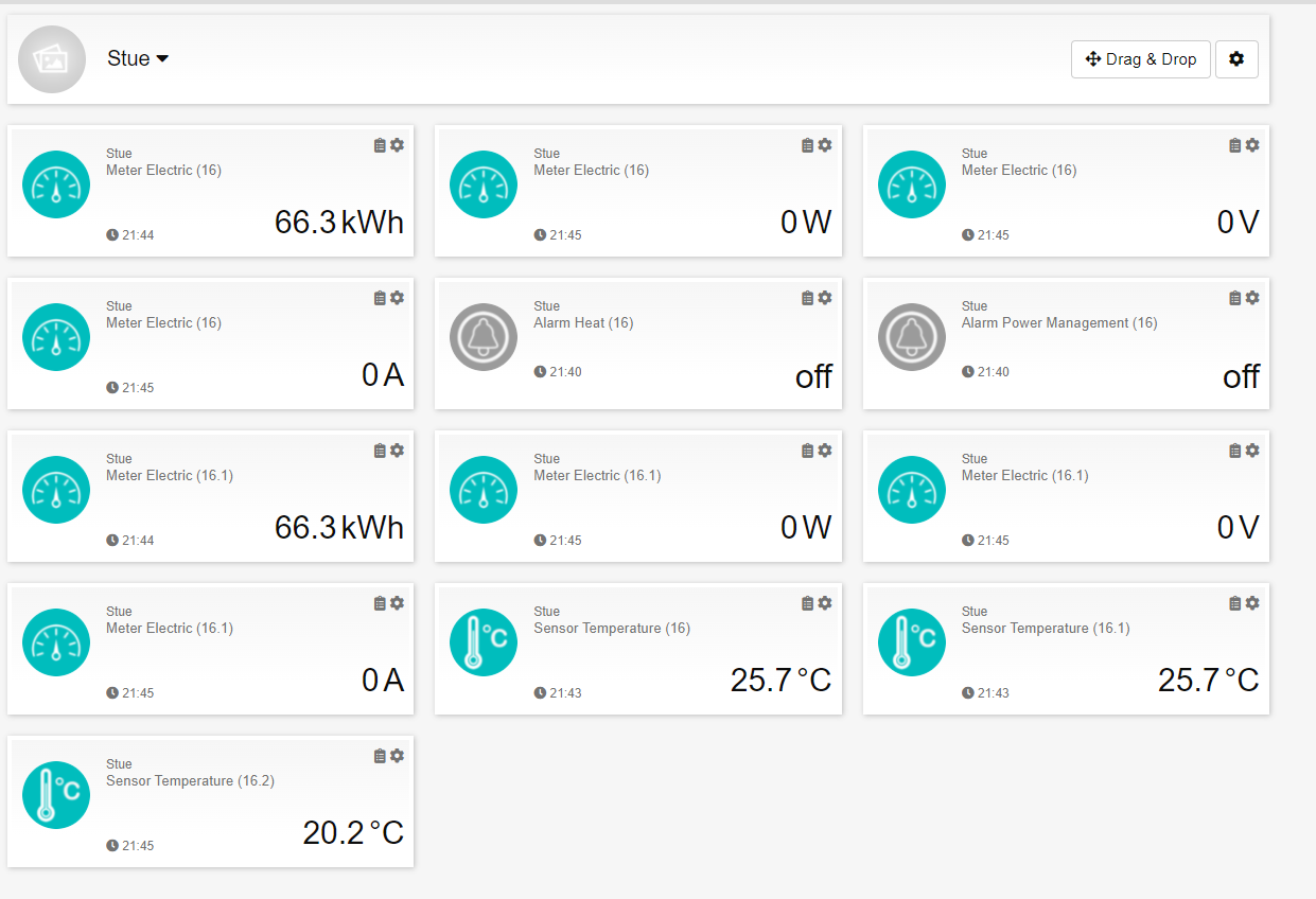

I cannot control the thermostat state, nor the temperature from the normal GUI.
All sensors show up properly, but - not the controls themselves.

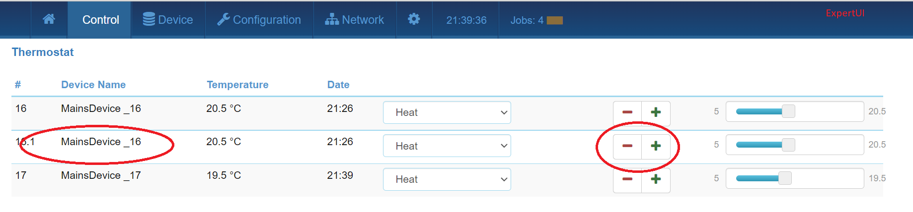

However - if I Navigate to the Expert UI, and Controls -> Thermostats, I can control it just fine..

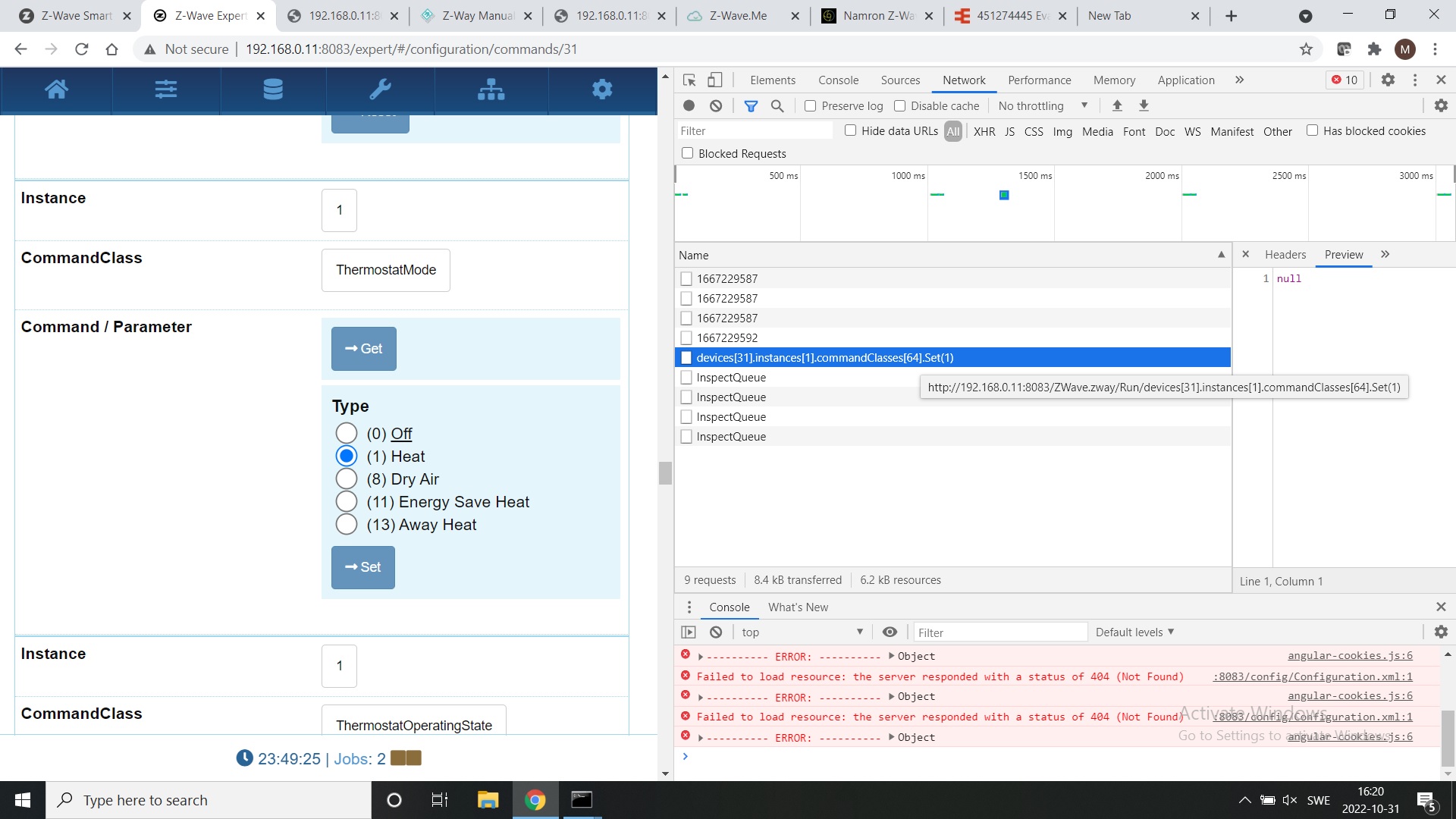

Sure, You can use a virtual device (using Code Device) to do anything via the ZWaveAPI layer
Re: Thermostat issues
Why is this not working?
I have followed the steps from this guide:
https://help.z-wave.me/en/knowledge_bas ... 28/cat/57/
Code for action on:
zway.devices[31].instances[1].commandClasses[64].Set(1); controller.devices.get("DummyDevice_120").performCommand("on")
Code for action off:
zway.devices[31].instances[1].commandClasses[64].Set(0); controller.devices.get("DummyDevice_120").performCommand("off")
Code to get value:
(zway.devices[31].instances[1].commandClasses[64].data.mode.value == 0 && controller.devices.get("DummyDevice_120").get("metrics:level") == "on") ? 'on' : 'off'
Code for action on:
Code to get value:
BR/
Marcus
