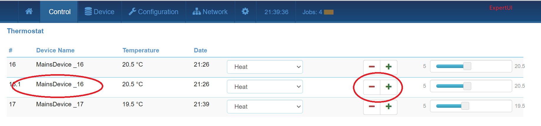

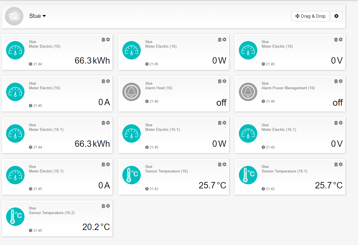

I cannot control the thermostat state, nor the temperature from the normal GUI.
All sensors show up properly, but - not the controls themselves.
However - if I Navigate to the Expert UI, and Controls -> Thermostats, I can control it just fine..
