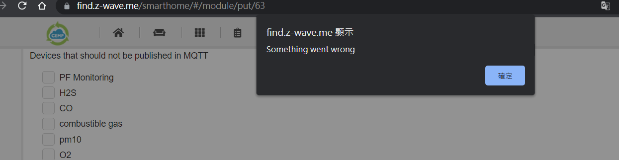

Re: MQTT setting problem
It will display like this in the attachment. and the following is the error code in the log
[2022-10-28 10:29:07.281] [core] Error: removeListener only takes instances of Function
at EventEmitter.off [as removeListener] (automation/lib/eventemitter2.js:419:19)
at _.extend.off (automation/classes/DevicesCollection.js:217:38)
at MQTTClient.stop (automation/modules/MQTTClient/index.js:185:26)
at AutomationController.stopInstance (automation/classes/AutomationController.js:975:12)
at AutomationController.reconfigureInstance (automation/classes/AutomationController.js
9)
at ZAutomationAPIWebRequest._.extend.reconfigureInstanceFunc (automation/ZAutomationAPIProvider.js
31)
at ZAutomationAPIWebRequest.handlerFunc (automation/ZAutomationAPIProvider.js:4006:30)
at ZAutomationAPIWebRequest.ZAutomationWebRequest.handleRequest (automation/WebserverRequestRouter.js:253:35)
at WebServer.ws.execute (automation/Webserver.js:127:9)
[2022-10-28 10:29:07.293] [E] [HTTP] Callback execution error: TypeError: Cannot read property 'prototype' of undefined
at MQTTClient.init (automation/modules/MQTTClient/index.js:33:19)
23)
31)
at WebServer.document_root (automation/Webserver.js:26:34)

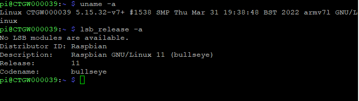

Looks like the MQTT module is not loaded. Please run Z-Way from the terminal and show the loading of modules. It should complain.
Please also show the Z-Way version and "uname -a" and "lsb_release -a"
How to check it?

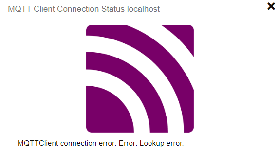

this one is error too
