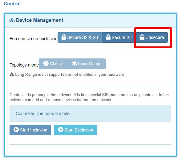

Sounds like your life has had a lot of drama. I'm guessing the Z-Wave inclusion problem with the ZW4006 is related to changes in version 3.2.3 dealing with secure inclusion and an overly strict policy. There have been many posts reporting similar inclusion problems. Here's 1 example: https://forum.z-wave.me/viewtopic.php?f=3419&t=35567
I think the easiest solution is to wait a few weeks for the Z-Wave.Me team to release version 4.0. If you're impatient, you can download and install a beta version of version 4.0 using this link: https://storage.z-wave.me/z-way-server/ ... _armhf.deb
Alternatively, you likely can force an unsecure inclusion using the Z-Way expert UI as shown below.
unsecure inclusion.jpg (37.42 KiB) Viewed 12102 times
With luck, the unsecure inclusion option will allow the ZW4006 to be included without errors.
