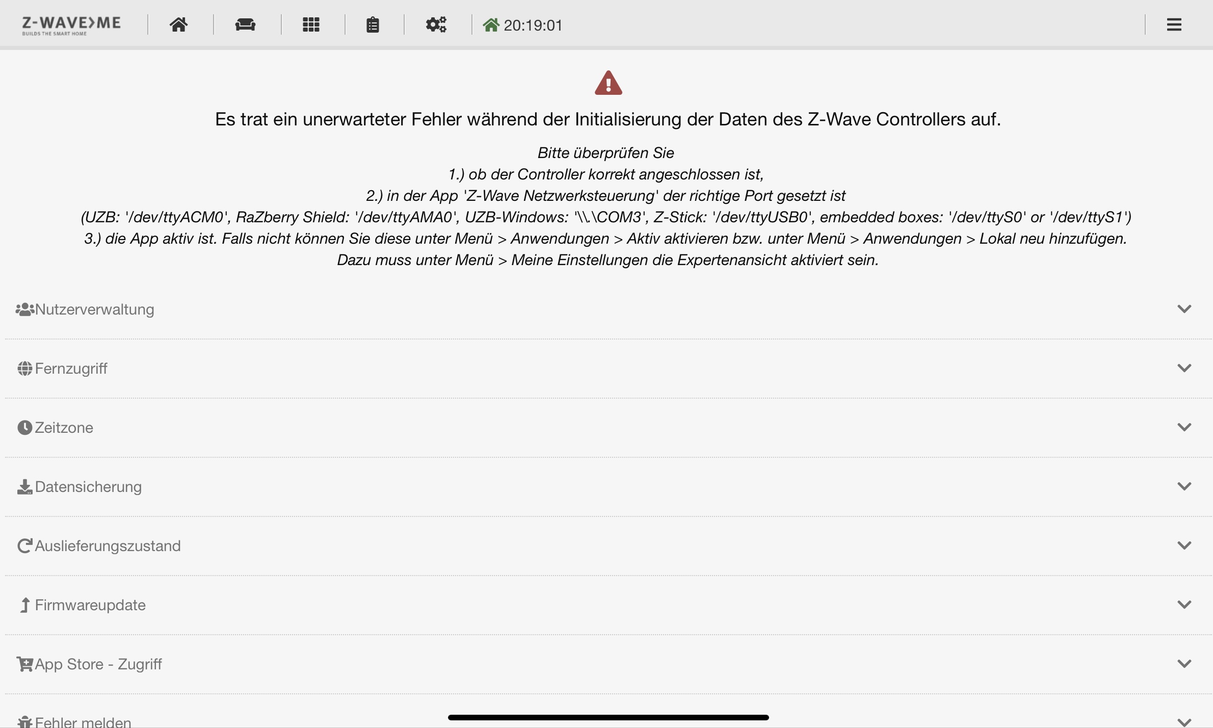

Hello, I bought a new Razberry 7 Pro and connected it to a Raspberry Pi 4. I installed Bullseye completely fresh and then installed Z-Way using " wget -qO - https://storage.z-wave.me/RaspbianInstall | sudo bash". Unfortunately, however, the controller does not seem to be recognized, although it is correctly mounted via " /dev/ttyAMA0". I only get the following error message which can be seen in the picture. Can someone possibly help me?

A couple of suggestions...
1. To confirm the serial port has been detected by the kernel, from shell prompt, run: dmesg | grep AMA0
You should see output for ttyAMA0.
2. To check if there's another process accessing /dev/ttyAMA0 (which is bad), from shell prompt run: sudo lsof -n | grep AMA0
You should only see the z-way-server process listed (there should be multiple threads, all belonging to the same process z-way-server process) - this assumes the z-way-server process is running.
3. Check the log file (/var/log/z-way-server.log) to see the error messages from Z-Way. You will likely need to stop and re-start z-way-server.

I have now found the error. To protect the SD card, I use Berryboot to boot from a USB hard drive. Obviously with Berryboot you have to adjust the config.txt file with the following values directly before the installation:
After the subsequent Z-Way installation it then also finds the controller.[pi4]
arm_boost=1
[all]
dtoverlay=pi3-miniuart-bt
Raspi 4 - (bullseye) Zwave Version 3.2.3 Raz 7 Pro, Serial API Version: 07.13
Re: Razberry 7 Pro is not recognized
The arm_boot only works on some Pi 4's and has nothing to do with the Razberry boards. Also the dtoverlay command is required for all systems and has nothing to do with Berryboot at all. The only image that it is not required is the image from Z-Wave.me as they already have it configured. Also there is a newer command:
