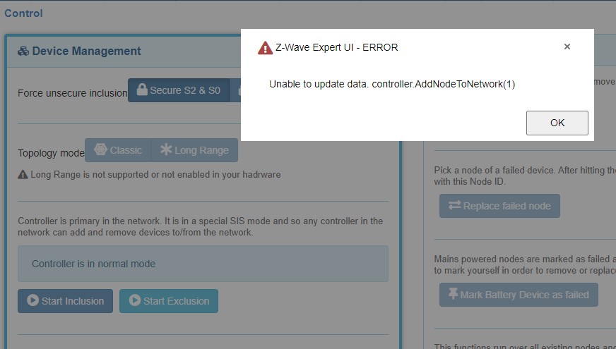

I've tried to reset the controller to factory default (in Z-wave.me expert UI Controller Maintenance / Controller Factory Default)
Trying to set it into inclusion mode just results in an error..
Does anyone have any clue on how I should proceed? Is it gameover for this Raz 7 device? :cry:
This is what I see if I try press "Start Inclusion"

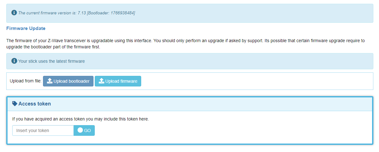

This is how the Firmware section looks.. (I did previously update the firmware using this section..)

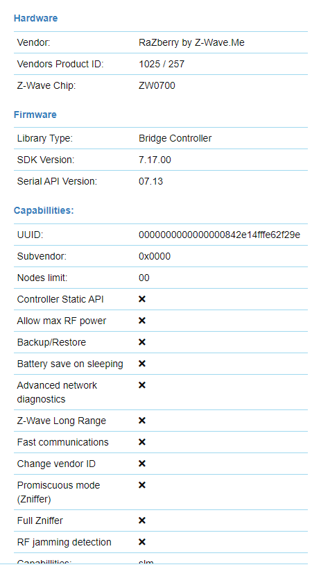

Capabilities of the device looks all wrong.. :(

Looks like you erased something important using this NVM function. Let me check with the R&D. Do you have the log from zwavejs to understand what you did?

I was able to upgrade the firmware to 7.28 but that did not help. When I try to add a node I get the following error in the log:
[2022-06-24 07:37:01.611] [I] [zway] Max number of devices (1) reached
