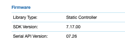

I don't know what happened, but... It seems something may have gone wrong when trying to update to 7.26 SDK 7.17.01...
Let me explain what happened:

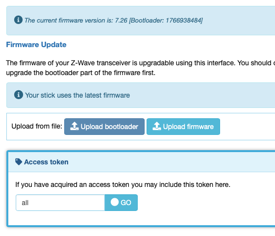

When I first filled the text box with "all" and pressed go, there was only one firmware available, which was 7.21. From this point, I was able to update to 7.21, without any problem. I waited until the page reloaded, went back to the Controller Info and was happy that it showed my board was now on 7.21.
I went back to the firmware update page, filled the token text box again with "all", and noticed there were still two firmwares available (7.21 to 7.26 SDK 7.17.01 and 7.26 to 7.28 SDK 7.17.02).
So I started the update to 7.26 SDK 7.17.01. It started as expected. I then left it running on a browser tab and moved on to another tab to write the above post.That's all I did, I did not close the browser window, or reloaded it in any way. I just changed the active browser tab.
I'm afraid moving into a different tab may have gotten me into trouble, and I now regret not having waited without doing so, as when I went back to the tab where the firmware was being updated, around 2 or 3 minutes later, it seemed that the firmware update was finished.
Then, I tried filling the token text box with "all" again, as I still wanted to go from 7.26 SDK 7.17.01 to 7.28 SDK 7.17.02, but the newer version doesn't show anymore, even after filling out the token text box and pressing the GO button... The image below shows what I get after I type all and press GO:

The controller info page now shows:

I have already tried waiting for around 10 minutes, then I tried rebooting the Pi, and when it came back online, nothing changed from the above.
My z-wave network still works, but I'm afraid I may have gotten my razberry 7 pro into an unpredicted state (7.26 SDK 7.17.00, instead of 7.17.01) and will need some help from support to put it back into an expected state.
Can someone with better knowledge help me in fixing this?
