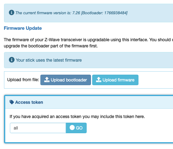

Then, I tried filling the token text box with "all" again, as I still wanted to go from 7.26 SDK 7.17.01 to 7.28 SDK 7.17.02, but the newer version doesn't show anymore, even after filling out the token text box and pressing the GO button... The image below shows what I get after I type all and press GO:

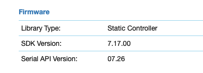

The controller info page now shows:

I have already tried waiting for around 10 minutes, then I tried rebooting the Pi, and when it came back online, nothing changed from the above.
My z-wave network still works, but I'm afraid I may have gotten my razberry 7 pro into an unpredicted state (7.26 SDK 7.17.00, instead of 7.17.01) and will need some help from support to put it back into an expected state.
Can someone with better knowledge help me in fixing this?
