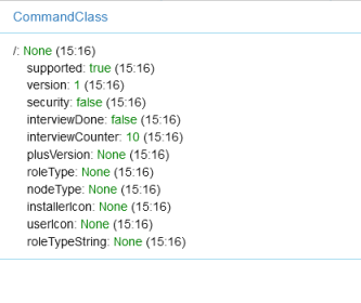

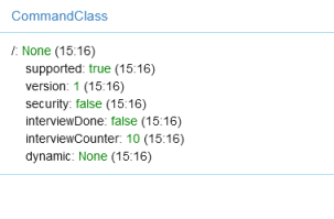

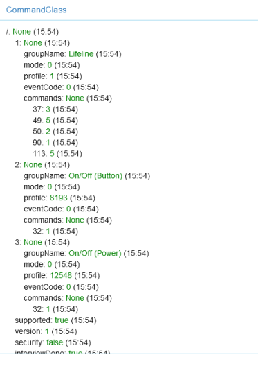

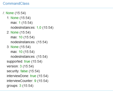

I can include devices, just that security interview fails when including in 'S2', or all interview is interrupted when including in 'S2 & S0', as illustrated below. ('S2' inclusion results further down.)
Command Class logs when inclusion in 'S2 & S0':
Basic:
Association Group Information
Multi Channel Association
Z-Wave Plus Information
And these are the logs for the same Command Classes when inclusion is done in 'S2'
For both inclusion tests the same device was used, reset to factory defaults before inclusion process was started.
