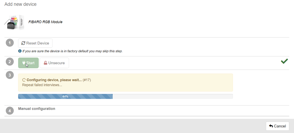

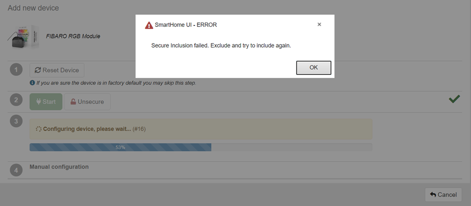

I want integrate a Fibaro RGBW Controller 2 FGRGBWM-442, but the process is not able to finish.
First Step "Reset Device" works. Then I start the configuring part and first it looks good but then the comes the message "Repeat failed interviews". Finally the comes a message "Secure Inclusion failed. Exclude an try to include again". I did a lot of retries (Secure, Unsecure), every time with the same result.
I have another FGRGBWM-442 which works, but der inclusion process has problems too. I shows me the same message "Repeat failed interviews", but then i could quit another message to continue without optimal inclusion and it seems that it works.
Is there a problem with the FGRGBWM-442? In the List with Fibaro components is only the rgb-101 selectable, which i have used.
Problem Inclusion Fibaro RGBW Controller 2 FGRGBWM-442
- Bild_2022-07-24_225006219.png (55.08 KiB) Viewed 24122 times
- Bild_2022-07-24_224943992.png (47.57 KiB) Viewed 24122 times

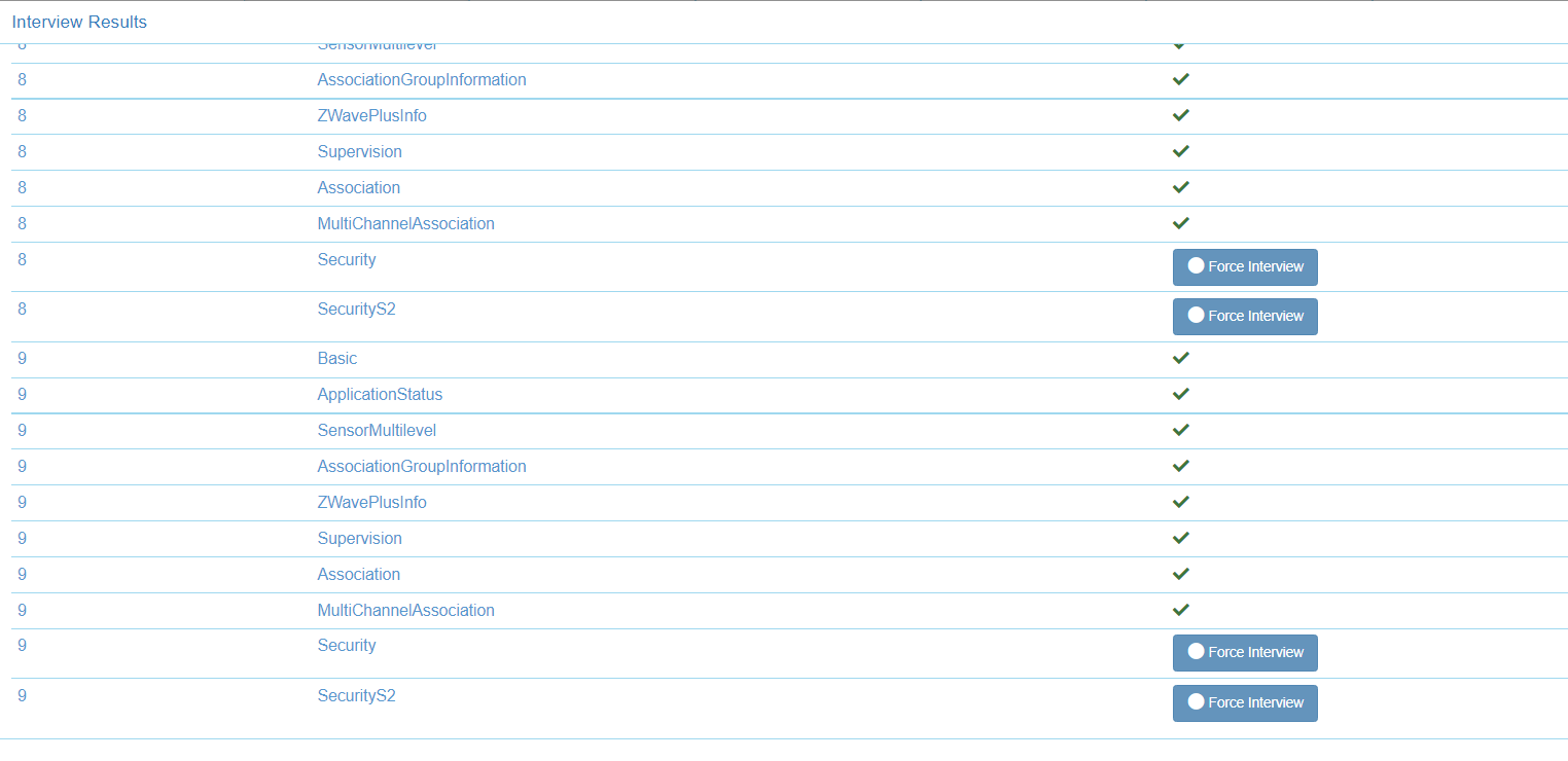

On the screenshot you can see, that the commandClasses Security and Security S2 failed.
In the elements view i have a lot of elements for the rgbw device some of them 3 times and more. Some of the elements are working but very slow and they do not what they should do.

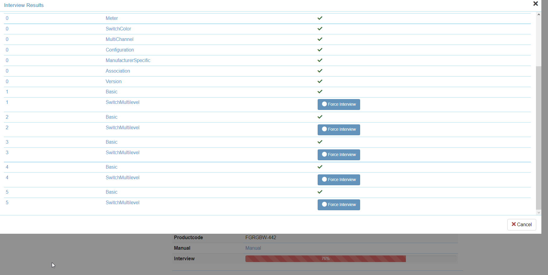

Another RGBW-442 which is working comes up to 76% in Expert UI after Force Interview:
- Bild_2022-07-25_204729546.png (47.14 KiB) Viewed 24114 times

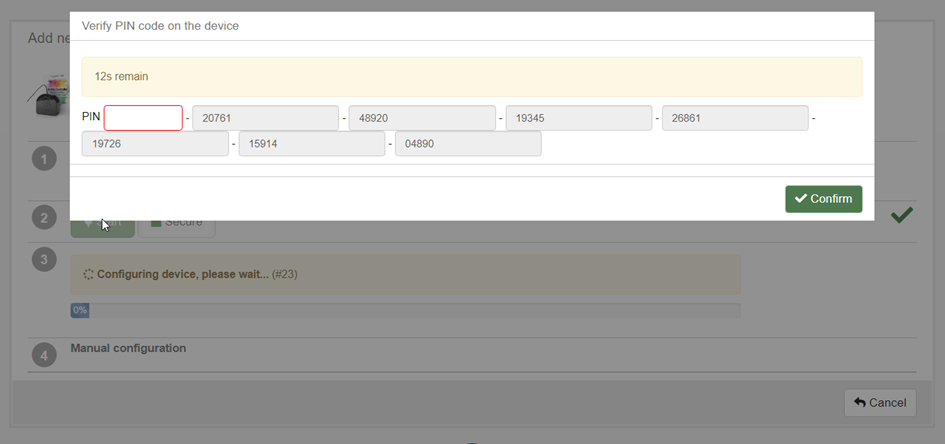

Re: Problem Inclusion Fibaro RGBW Controller 2 FGRGBWM-442
Looks like you have included device without security. You should re-include it with security and show the log if the problem persists
With security doesnt work. The I get an input dialog asking me for a PIN code.
Other Fibaro controls I can include with or without security, both works.
One thing I did: I reseted the device one time by holding the B-Button over 10 seconds. Maybe this was a mistake?
- Bild_2022-08-01_110929412.png (41.58 KiB) Viewed 23972 times
