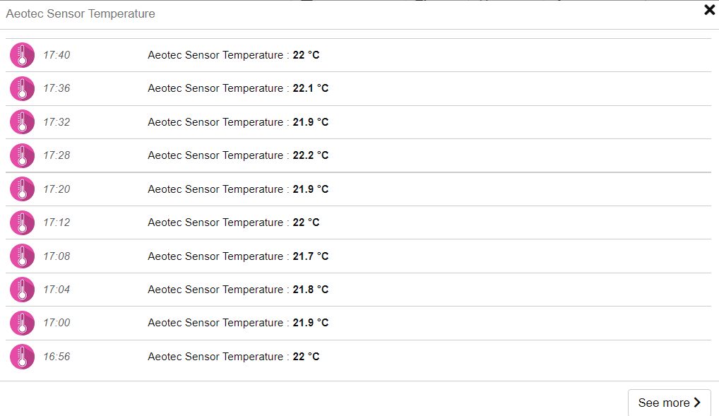

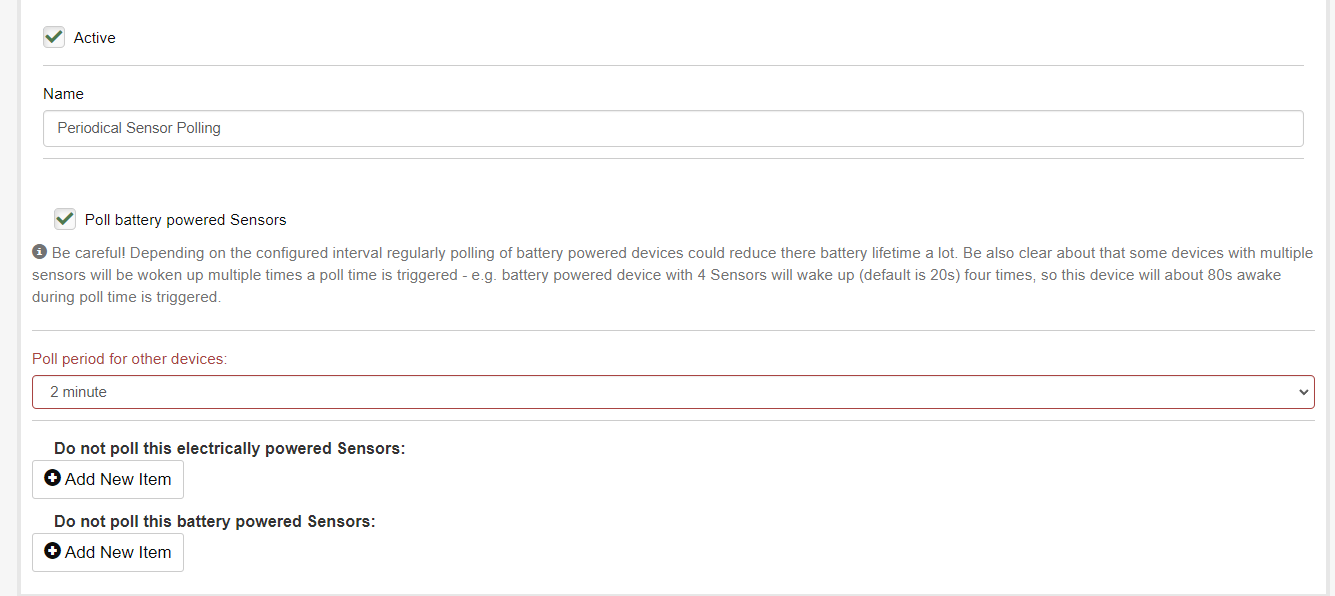

I use Periodical Sensor Polling to automatically update the device status, but it is not working well.
螢幕擷取畫面 2022-12-07 174645.png (37.43 KiB) Viewed 11477 times
But the sensor is not updated according to the Periodical Sensor Polling setting, it updates its value according to the hardware setting in the sensors.
螢幕擷取畫面 2022-12-07 174729.png (53.67 KiB) Viewed 11477 times
Is it possible that the sensor will update the values according to the Periodical Sensor Polling setting?

The sensor has a minimal wakeup time of 4 minutes, so no.
I would suggest to disable this module and instead set up hysteresis on the sensor to report values automatically without polling. This will save sensor's battery life

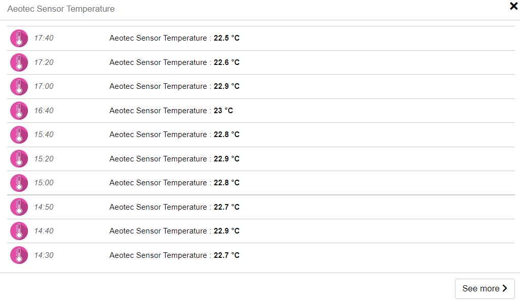

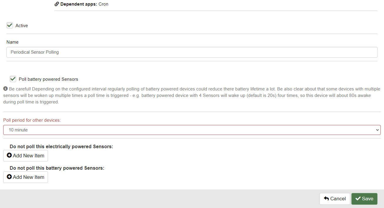

When I set it to 2 mins, it will update every 4 mins, and also, When I set the Periodical Sensor Polling to 10 mins, it will update it in sensors every 20 mins, why does it happen?

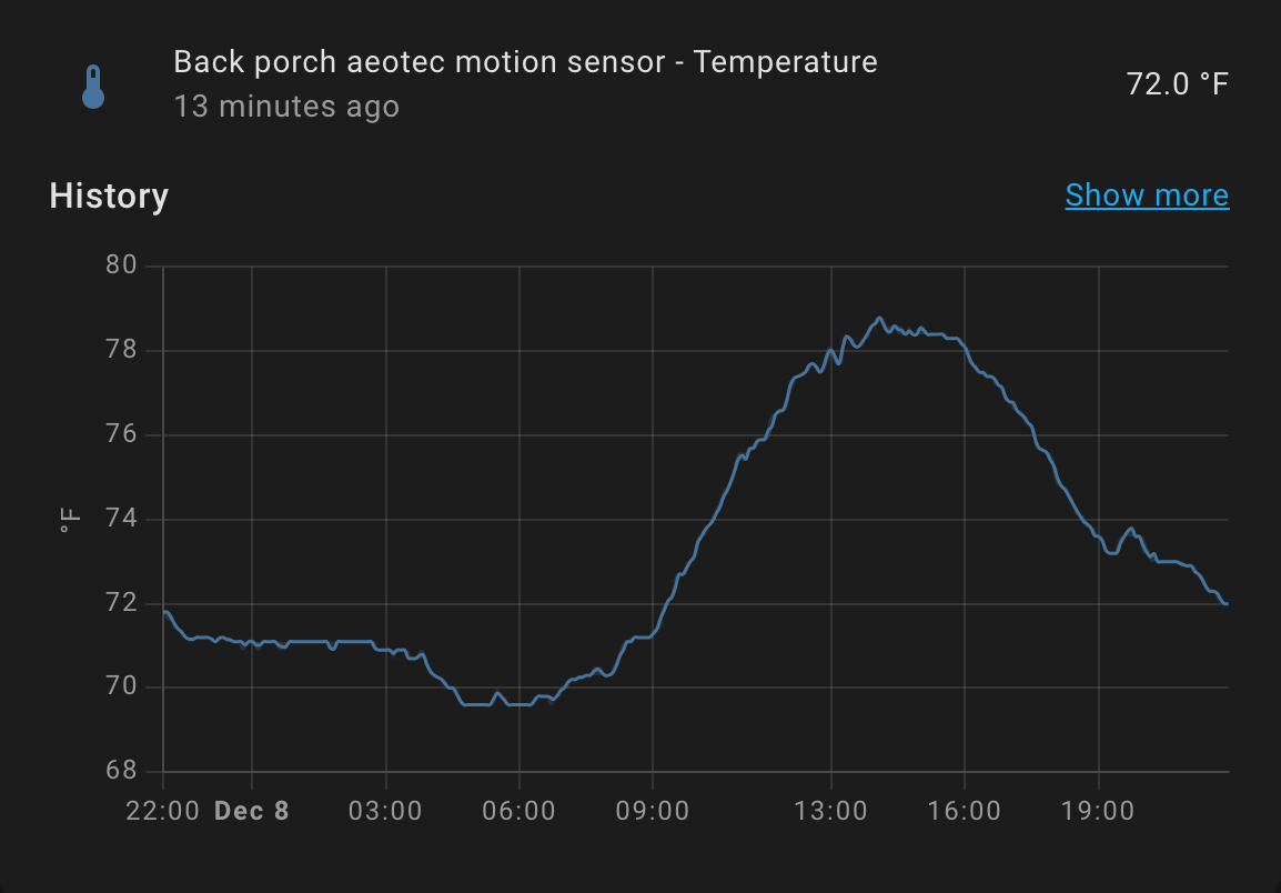

Here is mine, it is not polled, it sends out temperature changes on its own.
